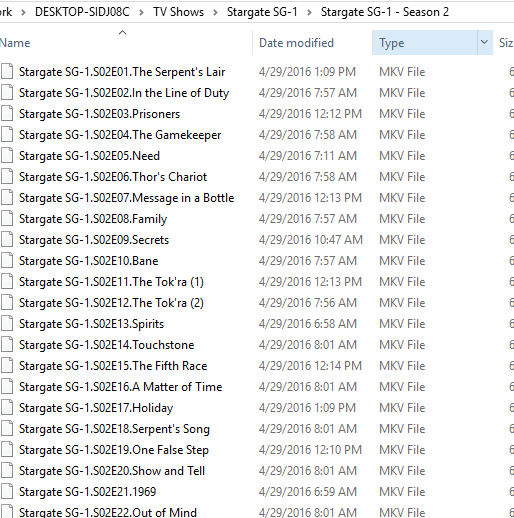

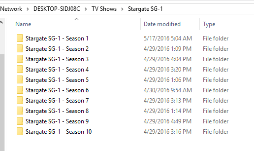

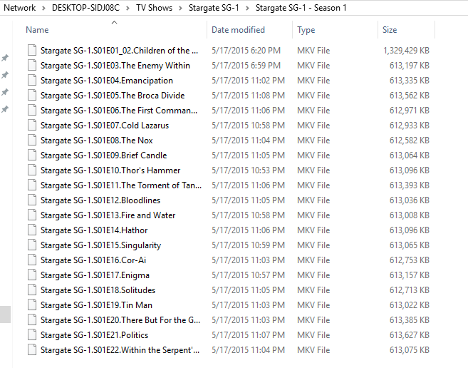

Luke 42204 Posted October 30, 2017 Posted October 30, 2017 Can you show a screenshot of the files? Thanks.

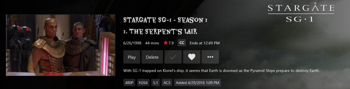

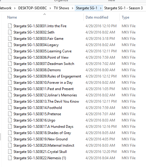

rcarteraz 12 Posted October 30, 2017 Author Posted October 30, 2017 Can you show a screenshot of the files? Thanks. Sure. Here's a view of the seasons 1-3. Let me know if you need more.
Luke 42204 Posted October 30, 2017 Posted October 30, 2017 Ok, try using the emby metadata editor to check the season folders and make sure they have the correct season numbers. if they are correct, then try checking some of the episodes underneath. let us know the outcome. thanks.
rcarteraz 12 Posted October 30, 2017 Author Posted October 30, 2017 Ok, try using the emby metadata editor to check the season folders and make sure they have the correct season numbers. if they are correct, then try checking some of the episodes underneath. let us know the outcome. thanks. The Metadata Manager is also displaying all episodes under Season 1. Each episode appears to have the correct metadata info other than the Season. As you can see with the included screenshots.

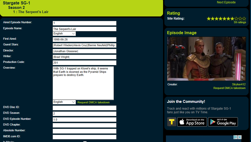

Happy2Play 9802 Posted October 30, 2017 Posted October 30, 2017 (edited) The Metadata Manager is also displaying all episodes under Season 1. Each episode appears to have the correct metadata info other than the Season. As you can see with the included screenshots. Well you show s01e01 but tmdb shows s02e01 in this screenshot example (post #5). Did Emby provide the metadata? Edited October 30, 2017 by Happy2Play
rcarteraz 12 Posted October 30, 2017 Author Posted October 30, 2017 (edited) so the episodes are correct but the seasons have the wrong season numbers? Yes, it appears all the episode information is correct. Emby for some reason though is displaying them all as Season 1. Well you show s01e01 but tmdb shows s02e01 in this screenshot example (post #5). Did Emby provide the metadata? That's the problem. Emby is displaying every season under season 1. The episode that was screenshot is S02E01, the file is labeled as S02E01, however Emby is displaying it as S01E01 but with the metadata for S02E01. It is doing this for all episodes. Edited October 30, 2017 by rcarteraz

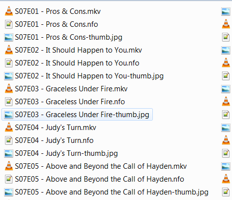

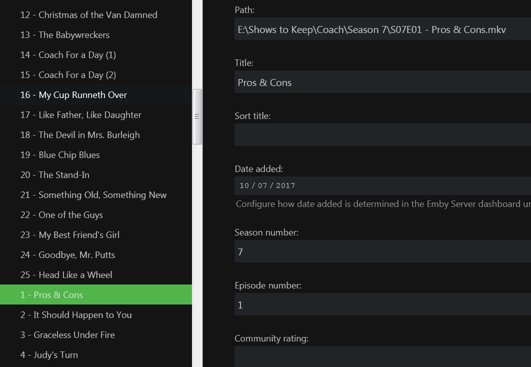

ifignella 12 Posted November 18, 2017 Posted November 18, 2017 @@Luke, I am experiencing this also. It's only on one series where season 7 in webapp, roku, etc. is in season 6 folder. all episodes are named correctly, all season folders are named correctly,the .nfo files are labeled for season 7. everything is set up the way it should be and the way it is for all the other series i have. not sure why it's showing them in the wrong place.
Luke 42204 Posted November 18, 2017 Posted November 18, 2017 Check the season and episode numbers for each episode using the metadata manager.
ifignella 12 Posted November 18, 2017 Posted November 18, 2017 Check the season and episode numbers for each episode using the metadata manager. yes, in my post i mentioned those are all correct. same as all the other 75 series i have. do you even read the posts or just resort to user error as the problem?
Luke 42204 Posted November 18, 2017 Posted November 18, 2017 As part of troubleshooting i need to see it myself because very often users will say they are filled in but it's only in the filename and they're not realizing i'm asking about the server metadata.
ifignella 12 Posted November 18, 2017 Posted November 18, 2017 (edited) i understand. in the first picture a few posts up, it shows it's recognized as season 7 on the right side, but the left side is a continuation of season 6. I couldn't fit it all in to the image. Edited November 18, 2017 by ifignella
Luke 42204 Posted November 18, 2017 Posted November 18, 2017 can you try refreshing that series from the series detail screen? then give it a few minutes and see if that corrects things. also check the season numbers on the seasons. thanks.
ifignella 12 Posted November 18, 2017 Posted November 18, 2017 ok, I tried that before but I did it again using all 3 of the options for refreshing. It didn't work. So I went on the hard drive and took out season 7, then refreshed. Season 6 then showed as expected (with just the episodes for S6 in the metadata manager). Then I went back in and added season 7 again and refreshed. All season 7 episodes showed back up under S6 in metadata manager. Very strange.
Luke 42204 Posted November 18, 2017 Posted November 18, 2017 Do they show up in season 7 as well, or only season 6?
ifignella 12 Posted November 18, 2017 Posted November 18, 2017 only six. season 7 doesn't show at all in metadata manager

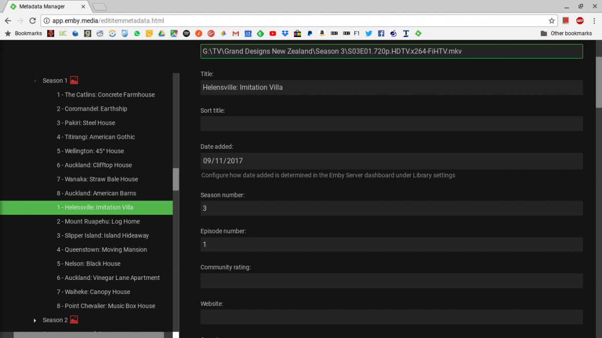

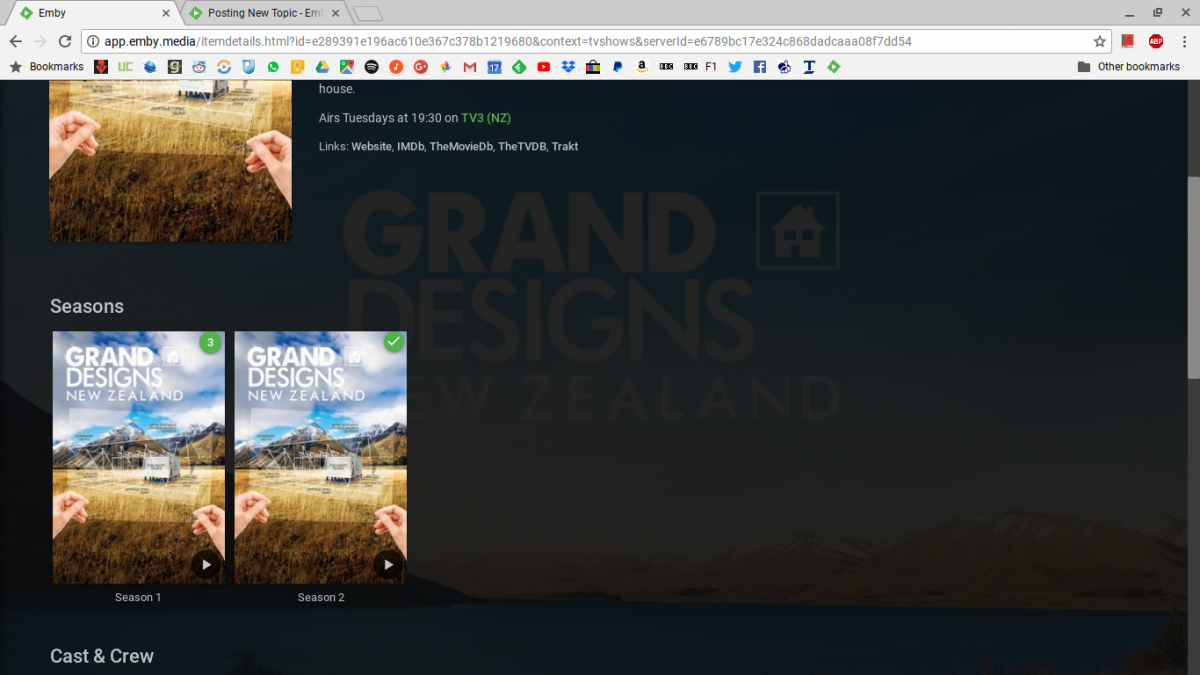

mattykellyuk 18 Posted November 18, 2017 Posted November 18, 2017 Hi I have a problem I haven't seen before where season 3 of a series has linked with season 1 and season 3 is not available as it normally is. Hopefully the screenshots attached gives all the details needed. Anything else you need please let me know. Thanks
