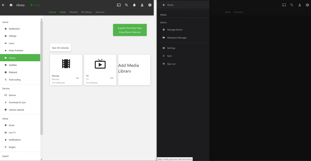

Luke 42245 Posted October 30, 2017 Posted October 30, 2017 Are you sure you re-added the libraries? what does your emby library setup look like?
pod0087 1 Posted October 30, 2017 Author Posted October 30, 2017 (edited) Left server, right user Edited October 30, 2017 by pod0087
Luke 42245 Posted October 30, 2017 Posted October 30, 2017 Ok, if you go into library setup where you would add a new folder, and then drill down into /mnt/Movies, is the directory picker able to see contents underneath that?
Solution pod0087 1 Posted October 30, 2017 Author Solution Posted October 30, 2017 Ended up just purging emby-server and reinstalling from scratch to fix it all. Far from an ideal solution with losing user credentials with no export ability though
Luke 42245 Posted October 30, 2017 Posted October 30, 2017 Thanks for the info. I think the folder visibility may actually have just been Emby user access permissions that needed to be reset.
