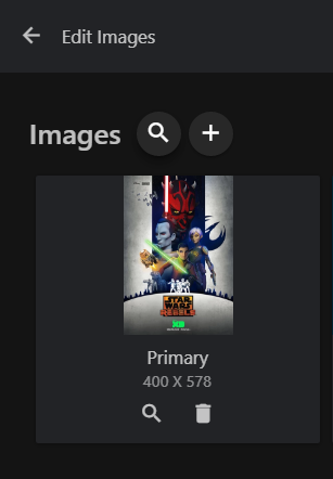

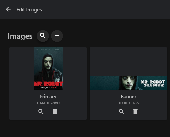

AkashKS 4 Posted October 29, 2017 Author Posted October 29, 2017 (edited) Hi, it does not downsize the original copies of the images but it does downsize for display purposes. Does this answer your question? Not really, unless I am misunderstanding. Let me give you an example. The following is an existing season of an existing show. I downloaded a poster sized 1944×2880. And the Edit Images page shows 1944×2880: The following is a newly-downloaded season of a newly-downloaded show. I downloaded a poster sized 1028×1500. And the Edit Images page shows 400×578: If it was just for display purposes, surely this would apply to all TV shows, both new and existing? EDIT: Just to confirm, I have been updated to 3.2.35.0, and the behaviour is the same. Edited October 29, 2017 by AkashKS
Luke 43457 Posted October 29, 2017 Posted October 29, 2017 You must not have downloaded at 1028×1500. Or perhaps the resolution was listed incorrectly in the data coming from the internet provider - was it moviedb?

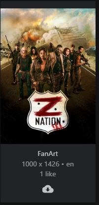

arche 177 Posted October 29, 2017 Posted October 29, 2017 Just my two cents and not sure it is related, every primary image that is bigger than 680x1000 gets resized back down to 680x1000. Tried one that was on fanart that was 1000x1426 and got resized back down to 680x1000. Not sure if this is related or even the same thing, but this is the only resizing I have seen with the primary image.
Luke 43457 Posted October 29, 2017 Posted October 29, 2017 Again, we do not resize the original that gets downloaded and saved into your folders. We do resize the image on the fly for display purposes, but that is it.
AkashKS 4 Posted October 29, 2017 Author Posted October 29, 2017 Just my two cents and not sure it is related, every primary image that is bigger than 680x1000 gets resized back down to 680x1000. Tried one that was on fanart that was 1000x1426 and got resized back down to 680x1000. Not sure if this is related or even the same thing, but this is the only resizing I have seen with the primary image. On checking, that (i.e. resizing to 680×1000) happened to me on the primary image of a new TV show. The primary image for the season is being resized to 400×578. And a banner for a new TV show from Fanart.tv (the one in the pic here) of size 1000×185 was it was downsized to 758×140. Sorry, I have just noticed the distinction in resizing between TV show level and season level. (In fact, the poster I used for the TV show level was 500×773 and upscaled to 680×1000.) [Thanks to nirvmedia for confirming this has happened to him. I thought I was going crazy!]
