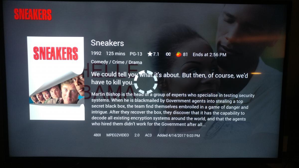

LloydGM 8 Posted October 27, 2017 Author Posted October 27, 2017 (edited) No info regarding logs, so I'm attaching what I hope will help the most. This log file shows using Emby after a fresh server reboot, connect to Emby via Chrome browser, play movie Sneakers in Chrome ok, then selected the option to play on other device, connected to TV fine and got the "loading" spinner (see screenshot) and it stayed that way for quite a while; I then canceled the failed playback and again started the movie in Chrome just fine. The log file should show all that activity. PS Looking in the log file for "error", I see port mapper references to a .104 address. That's really whacked out because that's the IP of another workstation on the network and nobody's even logged onto that box. IPs are DHCP-assigned but all computers have reservations so always get the same IP. Why would Emby be trying to map to that .104 address in the 1st place? server-63644705230.txt.txt Edited October 27, 2017 by LloydGM
