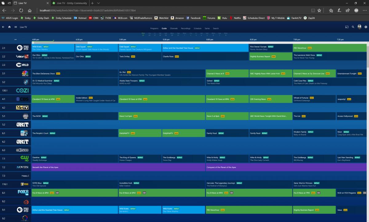

kanipek 230 Posted October 25, 2017 Posted October 25, 2017 Anyone else seeing issues with schedules direct epg info? I updated to .34 yesterday everthing was fine. Today lots of channels missing data again. I reverted back to .33 no change - still missing lots of data even cable card channels which I don't think Ihave seen before. I have seen a few threads about this recently don't see a solution. Screenshot and logs attached. xxx.3531 is 3.2.34 xxx.4508 is 3.2.33 Thanks for reading and any help. server-63644543531.txt server-63644544508.txt

kanipek 230 Posted October 25, 2017 Author Posted October 25, 2017 Yeah checked that they are. Look good.
kanipek 230 Posted October 25, 2017 Author Posted October 25, 2017 The logs look OK. check to see that the tuner channels are mapped to guide channels. Checked the mapping. Looks good for all the channels. Remapped a channel to different one (good data) data appeared good. Mapped it back to the original one still no data.

DarWun 357 Posted October 25, 2017 Posted October 25, 2017 I'm seeing the same thing as of several minutes ago after a guide update in Emby. I don't see anything unusual in the logs (attached). I updated the guide in NextPVR using the same schedulesdirect account, and listings for all channels populated as expected for fourteen days. server-63644486400.txt 1
SikSlayer 254 Posted October 26, 2017 Posted October 26, 2017 I'm seeing the same thing as of several minutes ago after a guide update in Emby. I don't see anything unusual in the logs (attached). I updated the guide in NextPVR using the same schedulesdirect account, and listings for all channels populated as expected for fourteen days. This is similar to what happened to me six months ago. NextPVR got the data on the channels that are missing it, but emby didnt.
