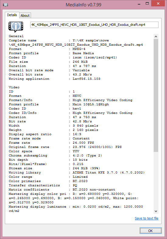

MrMind 2 Posted October 24, 2017 Posted October 24, 2017 My configuration: Windows 10 Fall Creators Update (fresh install)Geforce GTX760 with 388.00 drivers (fresh install)HDMI High Speed Cable 0.8MSamsung KS7000 (KS8000 in US), HDMI input set as Blu-ray player (if PC I can't change to "Movie" mode), UHD Color EnabledEmby Theater 2.9.3 with MADVR 0.91.10 (included), Madvr video player enabled I tried to play Life_of_ Pi_draft_Ultra-HD_HDR, Exodus_UHD_HDR_Exodus_draft and full length HDR movies. Nothing works. In MADVR settings I have: //C:\Users\Marcin\AppData\Roaming\Emby-Theater\COMObjects\madVR properties: PC levels, 10 bit (or higher)hdr: "passthrough HDR content to display" and "use Nvidia's private API"rendering -> general settings -> enable automatic fullscreen exclusive mode -> ENABLED In Nvidia Control panelRefresh rate: 30HzDesktop color depth: Highest (32 bit)Output color depth: 12 bpcOutput color format: YCbCr422Output dynamic range: Limited SCREENSHOTS: https://imgur.com/a/Azr9Q What should I change to play HDR movies?
