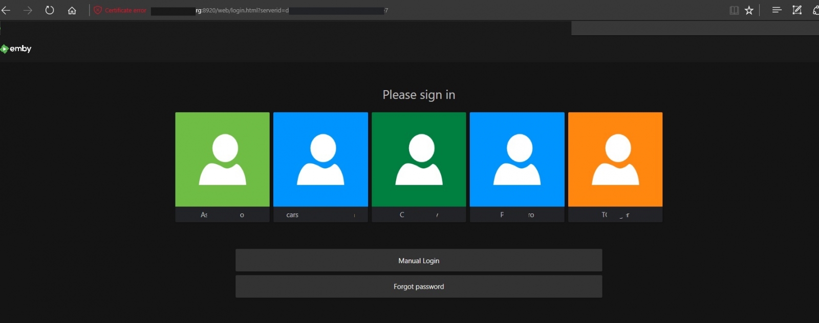

Happy2Play 9802 Posted October 24, 2017 Posted October 24, 2017 (edited) @@TALCCaro Sorry but I just logged into your server via ip and DDNS address. It is a little slow to respond but available. Edited October 24, 2017 by Happy2Play 2
Happy2Play 9802 Posted October 24, 2017 Posted October 24, 2017 (edited) add /web/home.html to your address Doesn't matter, it auto redirects. able to login via http and https self-signed @@TALCCaro You will need to sanitize this post. Edited October 24, 2017 by Happy2Play 2
Happy2Play 9802 Posted October 24, 2017 Posted October 24, 2017 Checking your IP shows the ports are open via www.yougetsignal.com. 2

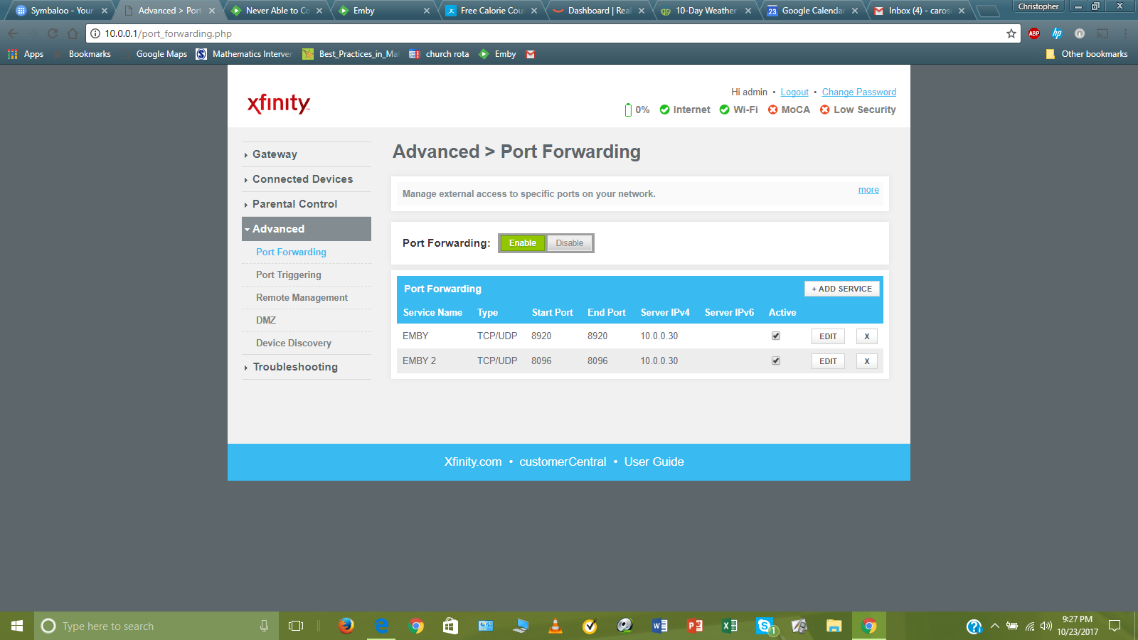

Tur0k 148 Posted October 24, 2017 Posted October 24, 2017 (edited) You may want to scrub your public IP address from your post. This is an unsafe practice. Did you DHCP reserve 10.0.0.30 on your home router for your Emby server? DHCP reservation is preferable but static IP assignment is the other alternative. If neither you will need to keep in mind that if your Emby server is ever assigned an IP address that does not match your home router's port forwarding rule for 8096 and 8920 it breaks. Inside your network you need to use the 10.0.0.30 IP address, unless you have a service called NAT REFLECTION/NAT LOOPBACK available and enabled on your home router. Without the above service available and enabled you won't be able to use your public IP address while on your internal home network. Your DDNS service will also not work internally unless you have: A. NAT REFLECTION/NAT LOOPBACK available and enabled. B. you could override DNS requests and direct them to 10.0.0.30 instead of your public IP address. This can be done by: 1. rewriting the HOSTS file on all your internal only devices (not optimal as this will break your dns lookup when on the public Internet when done on a mobile device). 2. Setup an internal DNS server (Pi-hole is a great solution and offers some security minded features) and setup all devices in your home network to use it for DNS lookups. Publicly, I can see that you have port 8096 and 8920 open. I can navigate to your insecure site using your public IP address on port 8096, as well as securely on port 8920. Sent from my iPhone using Tapatalk Edited October 24, 2017 by Tur0k 2

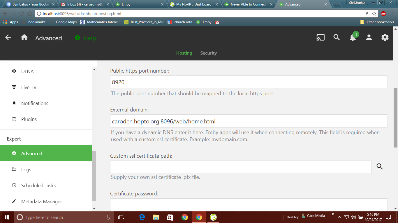

Luke 42203 Posted October 24, 2017 Posted October 24, 2017 @@TALCCaro says: When I click this remote address http://hostname/web/home.html:8096 within Emby I get Not Found in my browser. 1
Luke 42203 Posted October 24, 2017 Posted October 24, 2017 To which I responded: That's a bad url. Where did you get that? The port number goes after the host name: http://hostname:8096/web/home.html 1
TALCCaro 5 Posted October 24, 2017 Author Posted October 24, 2017 This is what is on my Emby Dashboard, as the remote access address.
mastrmind11 722 Posted October 24, 2017 Posted October 24, 2017 if http://hostname/web/...home.html:8096 is on your dashboard, then you've either jacked something up entirely, or it's not your server. 1

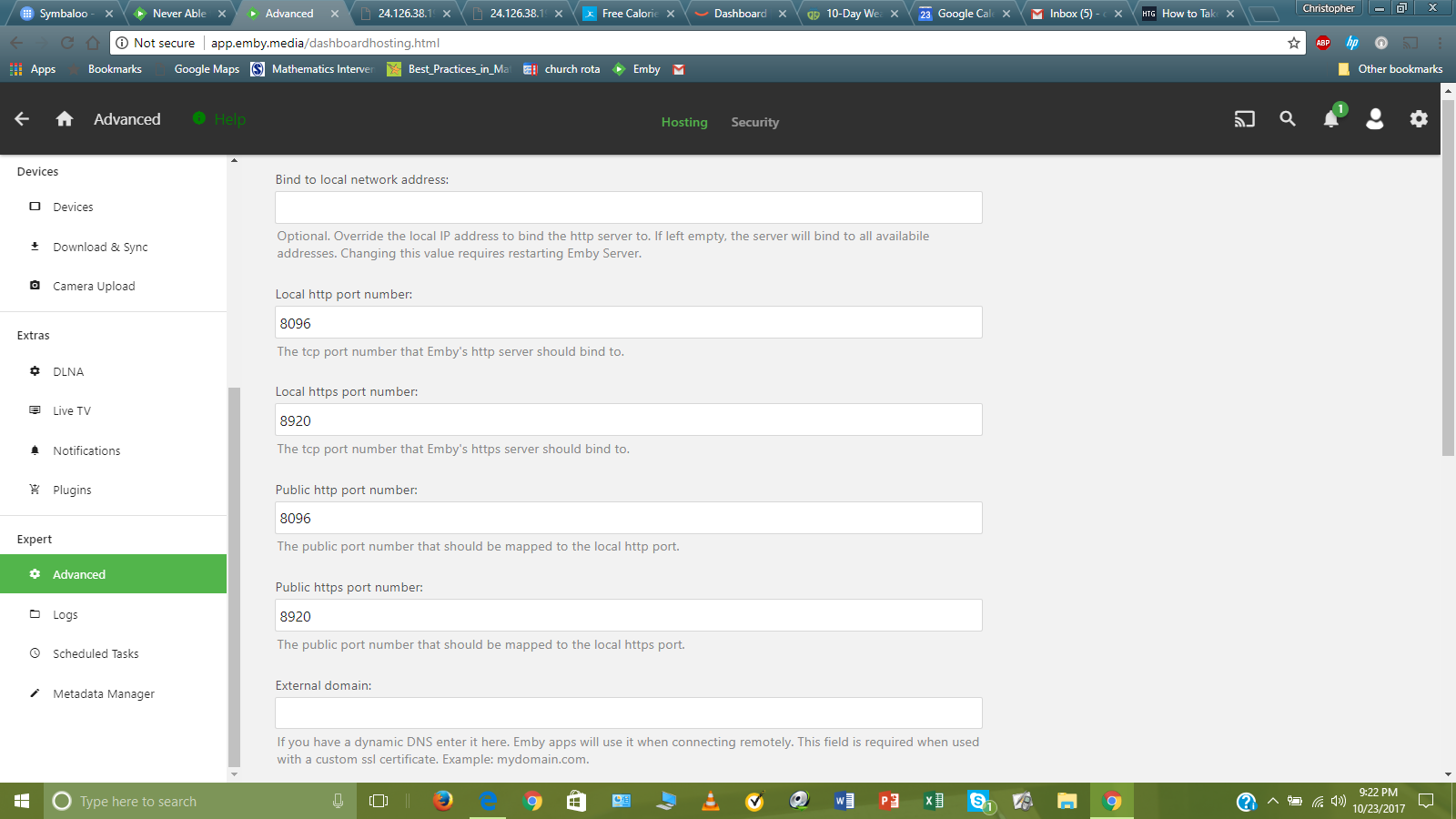

Luke 42203 Posted October 24, 2017 Posted October 24, 2017 This is what is on my Emby Dashboard, as the remote access address. You must have customized something under Advanced -> Hosting. Can you show us the complete contents of that screen? thanks. 1
Luke 42203 Posted October 24, 2017 Posted October 24, 2017 if http://hostname/web/...home.html:8096 is on your dashboard, then you've either jacked something up entirely, or it's not your server. I edited his hostname not to show it. The issue is the location of the port number. 1
mastrmind11 722 Posted October 24, 2017 Posted October 24, 2017 I edited his hostname not to show it. The issue is the location of the port number.I was reiterating that. Sent from my SM-G950U using Tapatalk 1
Solution Luke 42203 Posted October 24, 2017 Solution Posted October 24, 2017 External domain should be host name only. Remove everything after .org. 2
