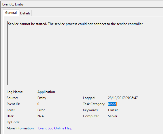

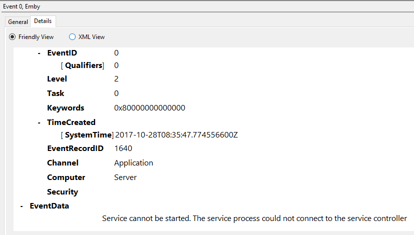

danswan 13 Posted October 27, 2017 Author Posted October 27, 2017 I'm not at the machine now, but the detail tab on the error just repeated the same message
