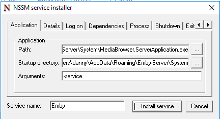

danswan 13 Posted October 23, 2017 Posted October 23, 2017 (edited) I've followed the guide to create the Emby Service, I've created a few other services using NSSM with no issue, but I can't get Emby to work. The guide is a little unclear, as I wasn't sure whether to use NSSM 64 or 32bit (it's a 64bit server, as you'd expect), but I've tried both ways, and either way I get the same thing. It's showing up in my list of services, but when I try to start it, it immediately stops. Event viewer just says "Service cannot be started. The service process could not connect to the service controller" I can see on here that other people have got this working OK. What have I done wrong? Edited October 25, 2017 by danswan

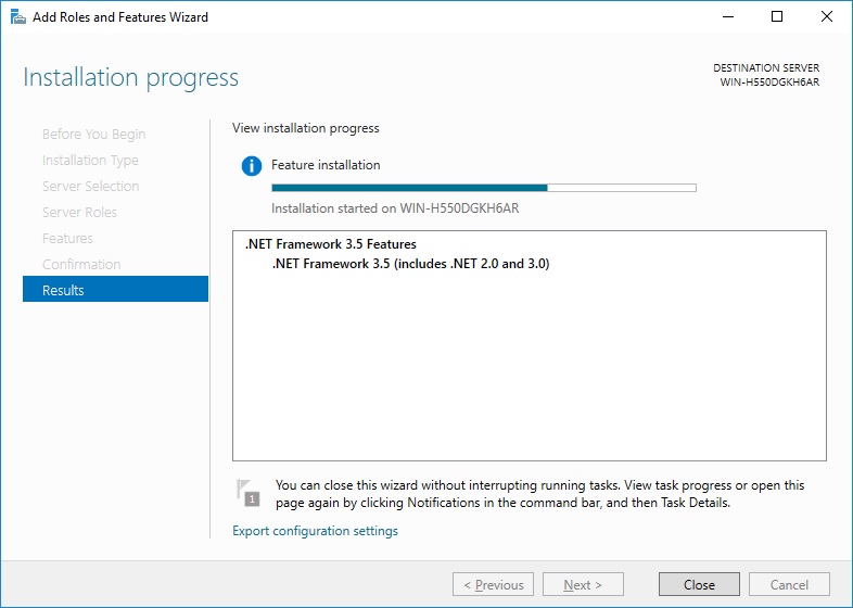

Happy2Play 9802 Posted October 26, 2017 Posted October 26, 2017 (edited) Have to wait net framework 3.5 features to install so I can uninstall Emby. Edited October 26, 2017 by Happy2Play

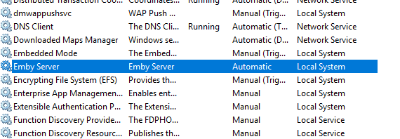

danswan 13 Posted October 26, 2017 Author Posted October 26, 2017 NSSM is x64 and login was default (Local System). I can't see there really being a difference with Stable and Beta server but I will test it now. Sounds like you've got exactly what I've got here. It looks like it's started (doesn't obviously error) but refresh the services screen and it's stopped a couple of seconds later

danswan 13 Posted October 26, 2017 Author Posted October 26, 2017 I'm an administrator, and I'm running NSSM from an elevated command prompt when installing the service
