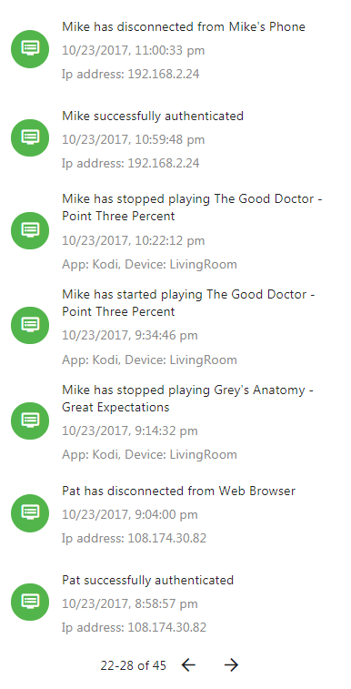

MRobi 161 Posted October 24, 2017 Author Posted October 24, 2017 Noticed the same issue come up last night. Watched Ghosted in the living room after completing The Good Doctor. Then watched The Big Bang Theory in the bedroom before starting Me, MYSELF & I. Attached 2 screenshots from Recent Activity which show the time gap with no logouts/logins, and the 2 most recent log files. Anybody have any ideas what could be causing this? Log1.txt Log2.txt

MRobi 161 Posted October 25, 2017 Author Posted October 25, 2017 Does this occur if you play something with the web app? No clue. The only time I ever use the web app is if I'm traveling. At home I have Intel NUC's running LibreElec hooked to every TV and seems to happen at random. Don't really plan to start watching all my TV through my 12" laptop monitor to try to catch the issue, my wife would shoot me. This happened again last night. 1 show in living room, 1 show in bedroom. Again between 10pm and midnight (2nd night in a row at this time) I noticed the library scan happened right in the middle of the 2 shows that are still showing as unwatched. Could be coincidence, but it's the only thing I saw happening in the background while these episodes played. I'm trying to change the task from every 12 hours to a set time so I can monitor, but I apparently can't edit or add new tasks. Must have a permission issue off somewhere that I need to dig into.

MRobi 161 Posted October 28, 2017 Author Posted October 28, 2017 Its like the connection between emby for kodi and the emby server is closing and sometimes it reconnects and sometimes it doesn't. That sounds like it's matching my observation when the server says "last seen X minutes ago". Beyond 5 minutes I can start the episode as many times as I want but it won't register as playing. When it resynchs and says "last seen 1 minute ago" it plays. Could the connection be going dormant after a certain number of minutes? I wonder if downgrading to an earlier version of Kodi, say 17.3 would still have the same issue? I never noticed it on any other version.
