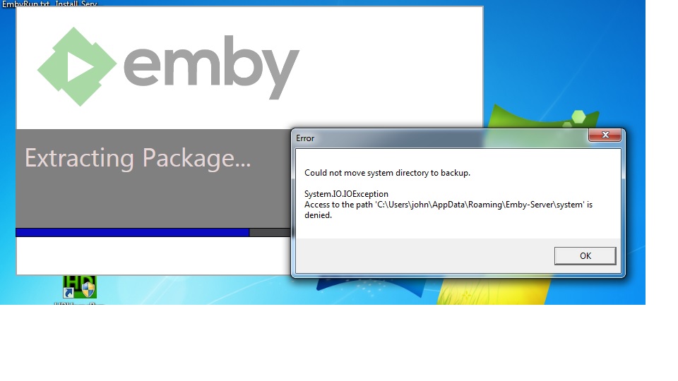

JohnsLibrary 9 Posted October 17, 2017 Author Posted October 17, 2017 Ok, I downloaded the beta version as you suggested. When I run it, I get the error in the attached screen shot. I have tried using "Run as Administrator" also with the same error.
Luke 42203 Posted October 17, 2017 Posted October 17, 2017 @@JohnsLibrary, try rebooting your system, then re-run the installer.
Happy2Play 9802 Posted October 17, 2017 Posted October 17, 2017 Are you running Emby as a Service? Since that error basically says Emby is running and I can't overwrite it.
JohnsLibrary 9 Posted October 19, 2017 Author Posted October 19, 2017 Installed the beta version and so far it's been running. Will post later if problems occur. Thanks for the help.
