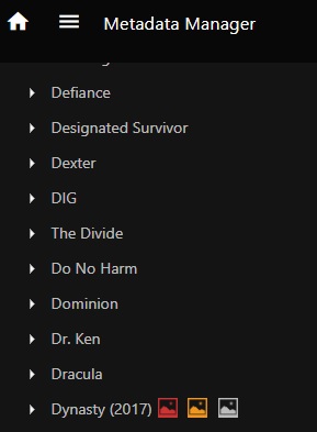

billneftleberg 3 Posted October 12, 2017 Posted October 12, 2017 (edited) ive added dynasty 2017 in a separate folder and hard drive from the original series but emby server wont list it what should i do old is listed as dynasty new series is dynasty 2017 I have no issues with both dr who series or both Mission impossible series but it just ignores the new dynasty Edited October 12, 2017 by billneftleberg
Happy2Play 9802 Posted October 12, 2017 Posted October 12, 2017 Emby won't pickup empty (New) Series folders, but put a empty Season 1 folder in there and it will appear(after library scan).
billneftleberg 3 Posted October 12, 2017 Author Posted October 12, 2017 (edited) Emby won't pickup empty (New) Series folders, but put a empty Season 1 folder in there and it will appear(after library scan). thanks but I tried that thats why its strange ive run several library scans and it just ignores the folder so far Edited October 12, 2017 by billneftleberg
Happy2Play 9802 Posted October 12, 2017 Posted October 12, 2017 My guess then is there might be a identification same name conflict, does it appear in Metadata Manager or if you use search. If so you may have to manually add a external providerID.
billneftleberg 3 Posted October 12, 2017 Author Posted October 12, 2017 My guess then is there might be a identification same name conflict, does it appear in Metadata Manager or if you use search. If so you may have to manually add a external providerID. no that was my first thought it doesnt even recognize the extra folder which is why i named the new folder as dynasty 2017
Happy2Play 9802 Posted October 12, 2017 Posted October 12, 2017 Sorry I just added a folder named "Dynasty (2017)" and performed a library scan.
billneftleberg 3 Posted October 12, 2017 Author Posted October 12, 2017 (edited) weird ok I added the folder empty on another hard drive ( i have 6) and now its seen. very strange. it wouldnt see it in the drive that only had 50 folders but its seen in one that has 200. thanks for your help at least you gave me some things to try and now it works Edited October 12, 2017 by billneftleberg
Happy2Play 9802 Posted October 12, 2017 Posted October 12, 2017 You will need to post a server log or look thru your server log to see if a issue can be found.
billneftleberg 3 Posted October 12, 2017 Author Posted October 12, 2017 You will need to post a server log or look thru your server log to see if a issue can be found. ok happy, moving the folder to another hard drive solved the issue it might be my library is too big i have 1184 separate tv series with 65,000 individual episodes
