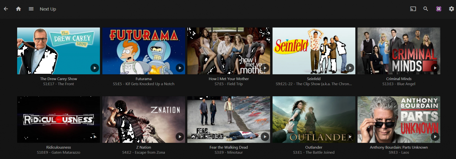

Jdiesel 1435 Posted October 12, 2017 Posted October 12, 2017 Just trying to troubleshoot why the new episodes of newly started started shows are not showing up in my next up section even though I've started to watch the new season.
Happy2Play 9802 Posted October 12, 2017 Posted October 12, 2017 (edited) I have 24 different Series episodes in TV\Suggestions\Next Up. And I believe 24 is the limit. Same for Home Screen Next Up Edited October 12, 2017 by Happy2Play

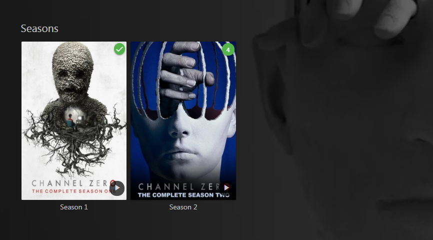

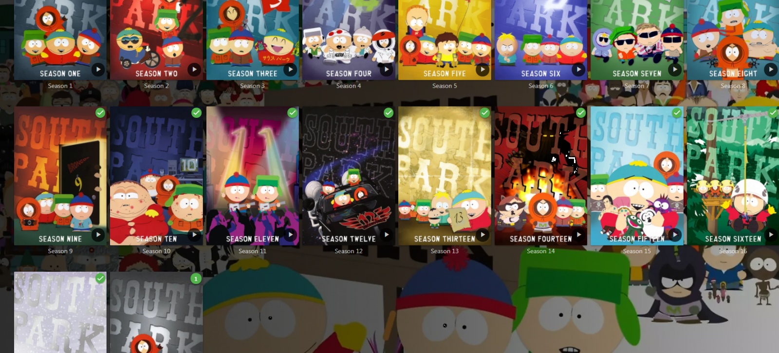

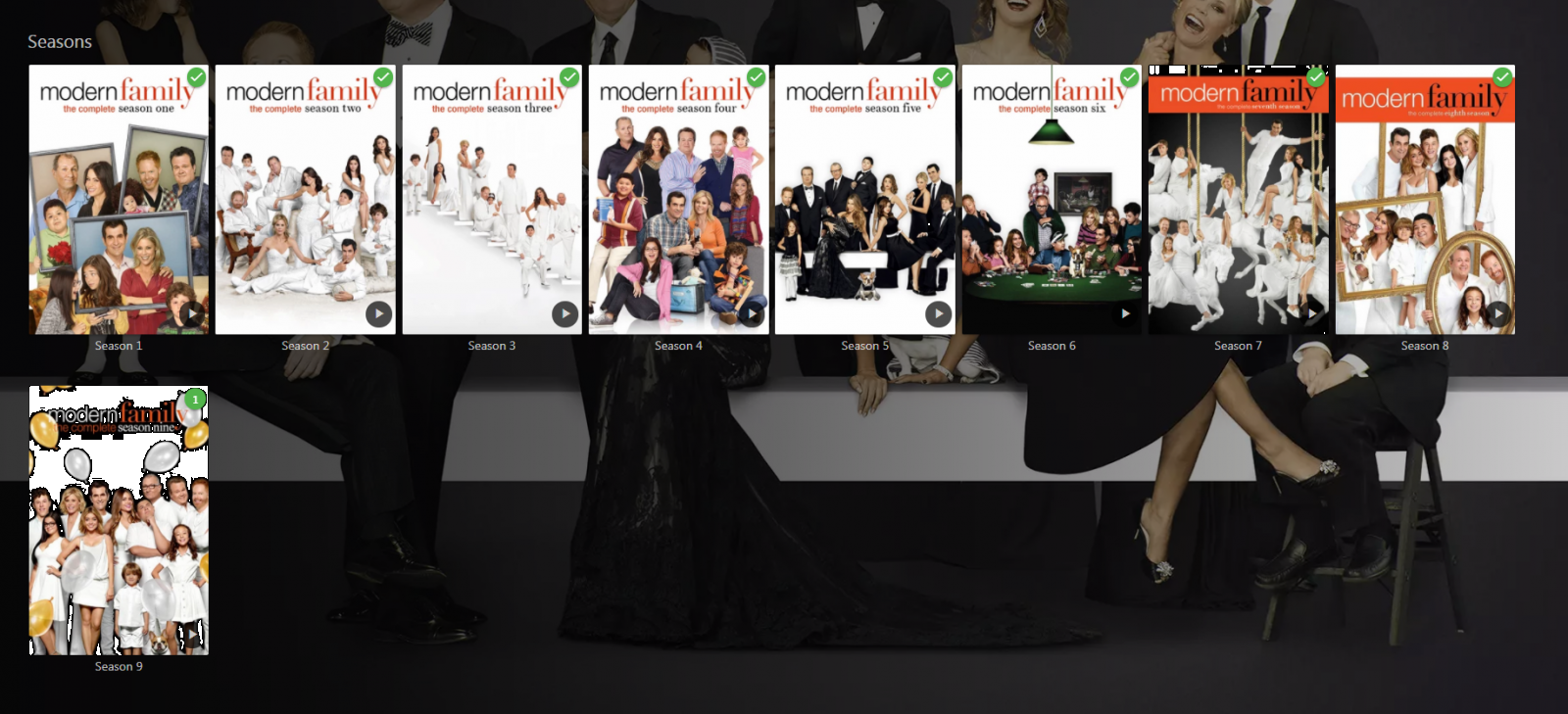

Jdiesel 1435 Posted October 12, 2017 Author Posted October 12, 2017 I have 24 different Series episodes in TV\Suggestions\Next Up. And I believe 24 is the limit. Thanks for confirming I don't know what information is needed to troubleshoot my issue so I will start by posting a few examples. My current Next Up queue consists of 10 shows A few series that I watch have started up this fall and I have begun to start watching new episodes as they are added. Example 1 Modern Family where I have watched 2 out 3 episodes from season 9 however last nights episode which has yet to be watched was not populated in the next up section Example 2 Southpark, same as above. I've watched 3 out of 4 episodes from the latest season but last night's episode was not added to the next up section. Example 3 Channel Zero, First season is marked as watched, no episodes from the second season have been watched.

Luke 42203 Posted October 18, 2017 Posted October 18, 2017 i would check the custom sort title value for of all the episodes in the modern family series. make sure they are all consistent, meaning, either they are all blank or they are all specified in a consistent manner.
Jdiesel 1435 Posted October 20, 2017 Author Posted October 20, 2017 In the case of Modern Family some sort titles are blank and some look like "modern family - s0000000007e0000000011 - spread your wings webdl-0000000480p" is there a simple way to clear them all?
Luke 42203 Posted October 20, 2017 Posted October 20, 2017 Well this explains the issue, likely due to a defect in an older version of the server. the fastest way to clear them would be some kind of bulk edit of nfo files, assuming you save to local metadata.
Jdiesel 1435 Posted October 20, 2017 Author Posted October 20, 2017 I do save to local nfo. Is sort title a user enter field or is it pulled from the metadata provider? I'm thinking of deleting all the nfo's and refreshing the metadata.
Jdiesel 1435 Posted October 20, 2017 Author Posted October 20, 2017 So I deleted all the sort title entries and it didn't fix things. I did notice that if I mark the series as watched at start marking seasons as watched the next up works correctly until I mark season 7 as watched at which point the episodes stop showing up in next up. Season 7 also happens to be the season with the messed up sort titles.
