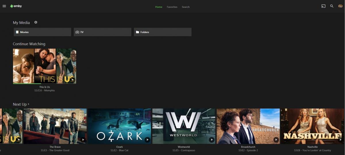

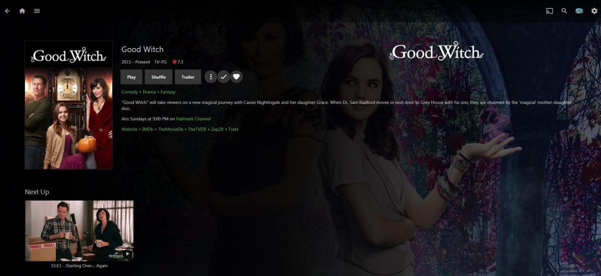

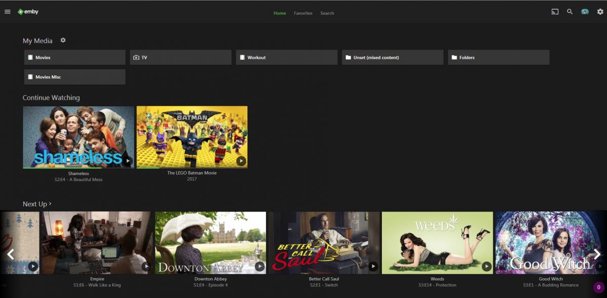

lal 4 Posted October 11, 2017 Posted October 11, 2017 (edited) I have 2 users on my server that now have random next up season / episodes showing up, here's one example: Emby Version 3.2.33.0 I've never watched Good Witch, yet it shows up in Next Up on the main screen for S03, E01 When I go in the Good Witch show itself, it shows next up S01 E01, confirming I've never watched it. Tried: I did a TV Series metadata refresh, no dice From researching the issue, I also checked my "Sort Title" in the metadata, found that they were all blank for all 3 seasons, all episodes Help Side note: The search rules of this site don't allow you to search for "Next Up" forum posts. I also tried "Next", it didn't like that either. I had to google and the results were limited, same with forum tags. edit: I had left out key info, corrected, sorry Edited October 11, 2017 by lal
Luke 42203 Posted October 11, 2017 Posted October 11, 2017 When I go in the show itself, it shows next up S01 E01, confirming I've never watched it. We do this by design.
lal 4 Posted October 11, 2017 Author Posted October 11, 2017 We do this by design. Agreed for the 2nd print screen. My 1st print screen shows the problem, is that by design also? You now show a Next Up for a show I never watched, random season?
lal 4 Posted October 11, 2017 Author Posted October 11, 2017 Ugh, sorry I wasn't clear at all. Screen 1 shows Next Up on the main screen, Good Witch S03, E01. I've never watched that show. Screen 2 shows Next Up on the series for Good Witch as S01, E01. Is Screen 1 now as designed?

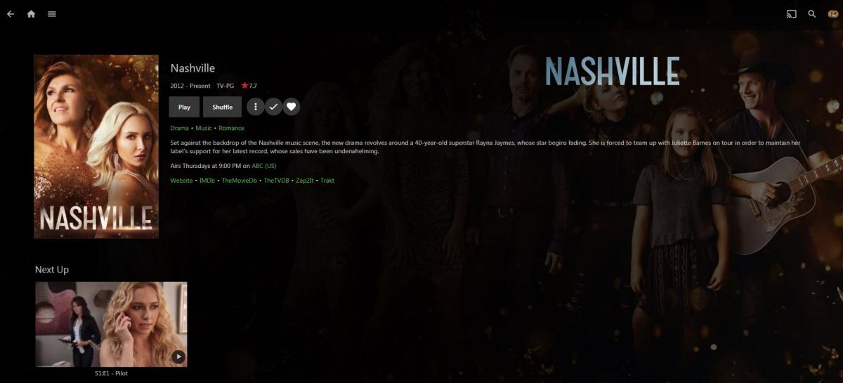

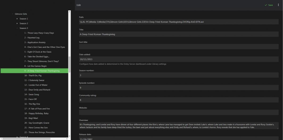

lal 4 Posted October 11, 2017 Author Posted October 11, 2017 (edited) I only have 1 folder that the library looks at, and it only has 1 folder for Good Witch. I checked every episode, they all have season and episode numbers. I already also checked for sort title, read that issue from another post, its blank for all of them. Here's another example from another account on my server, Nashville: I also checked sort title, episode and season #'s, and confirm only 1 folder. Yes, emby does all my metadata fetching Edited October 11, 2017 by lal
lal 4 Posted October 11, 2017 Author Posted October 11, 2017 Test I just did...I marked the entire Series as watched to see if it would nuke it from the Next Up main screen, refreshed, it's gone, but another show Gilmore Girls took its place as S03, E09. Going to the series page, it shows s01 e01 as next up, and the metadata is clean. Wen't back to Nashville, unmarked the series as watched and it returned to the next up list, but it "replaced" gilmore gils in the next up list. I didn't do anything to gilmore girls, it just disappeared from the next up list.

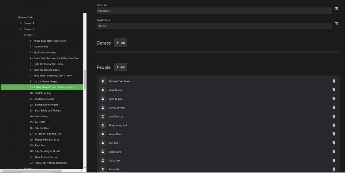

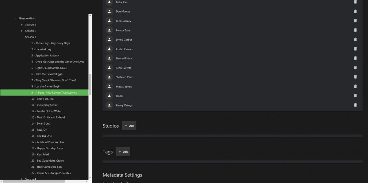

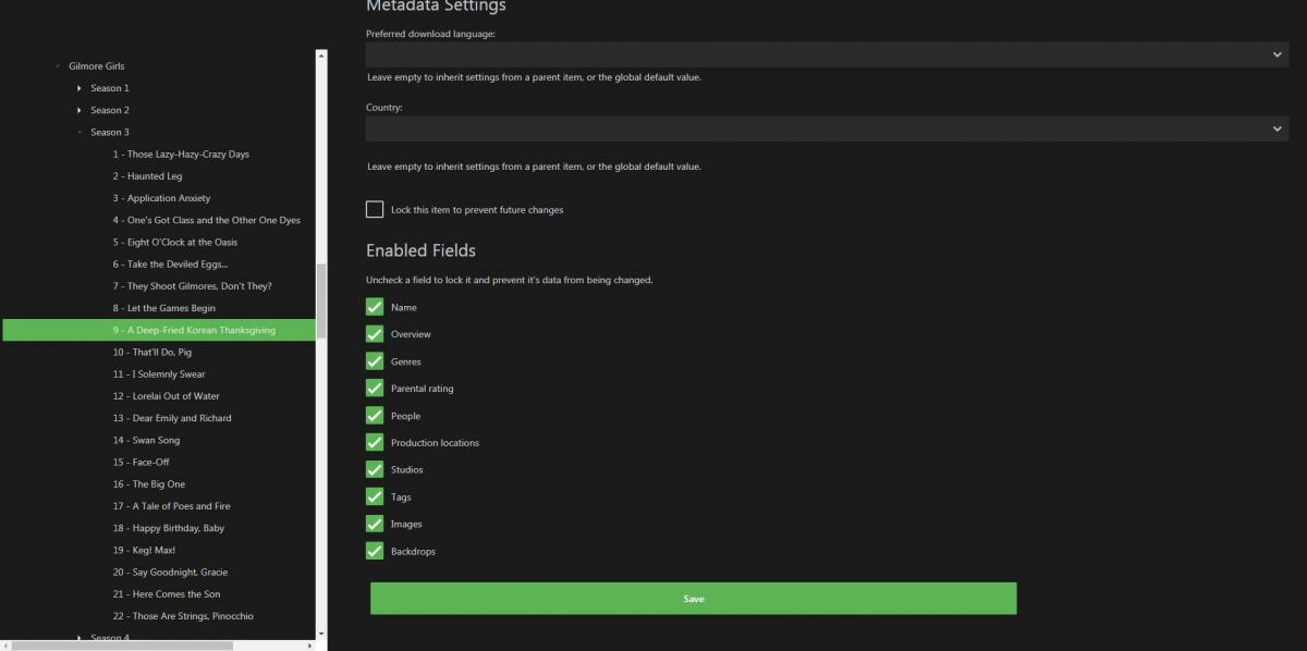

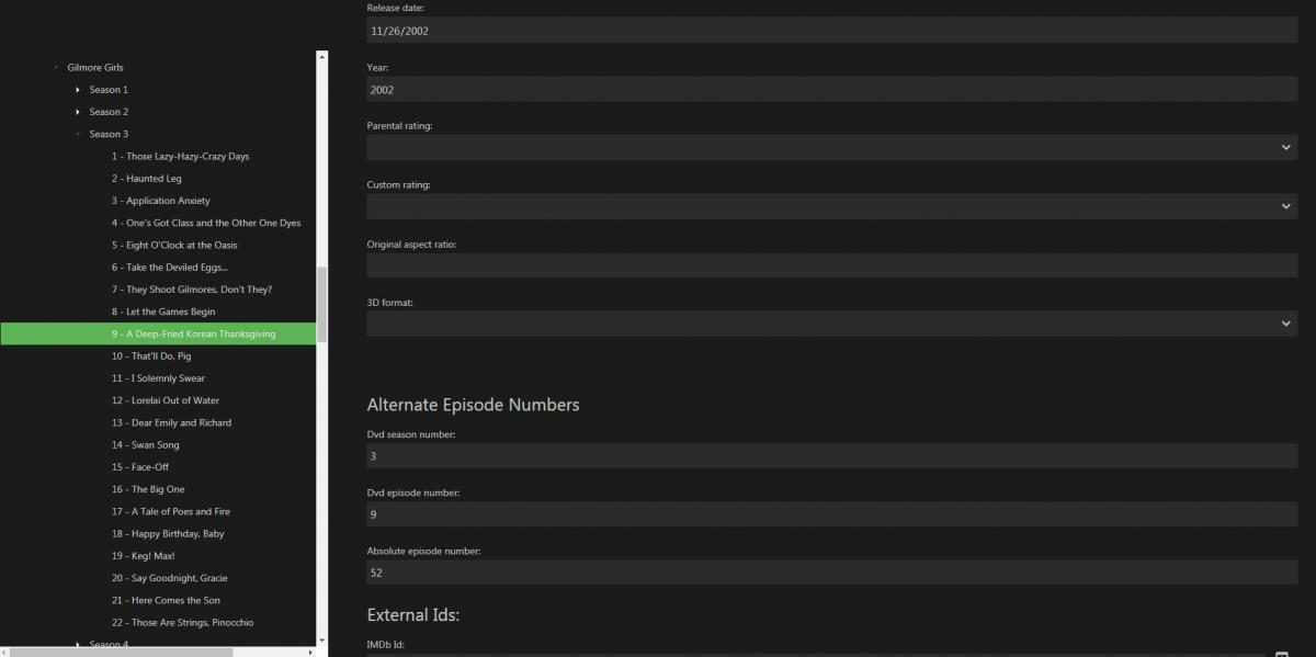

Happy2Play 9802 Posted October 12, 2017 Posted October 12, 2017 Can you show the metadata for one of the episodes that show in Next Up incorrectly.
