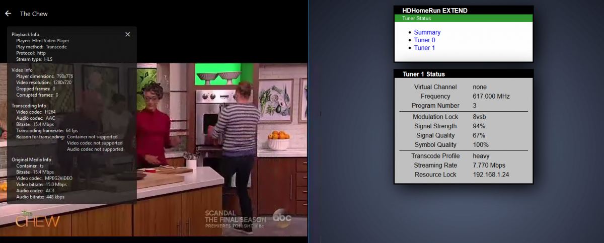

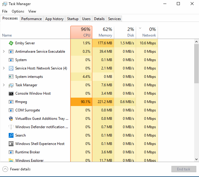

nagle3092 1 Posted October 5, 2017 Posted October 5, 2017 (edited) So I am trying to figure out why a full transcode is happening whenever I watch something from my extend in emby. The extend is already transcoding it using the heavy profile so why is emby transcoding it again? Edited October 5, 2017 by nagle3092

Luke 42243 Posted October 5, 2017 Posted October 5, 2017 In the very first log it looks like you need to increase the in-app quality setting. Please be advised, you have two methods that you can use to discover why something is transcoding all on your own: Stats for nerds feature inside video player Server dashboard Please let us know if this helps. Thanks.
nagle3092 1 Posted October 5, 2017 Author Posted October 5, 2017 In the very first log it looks like you need to increase the in-app quality setting. Please be advised, you have two methods that you can use to discover why something is transcoding all on your own: Stats for nerds feature inside video player Server dashboard Please let us know if this helps. Thanks. Seems like it is incorrectly flagging the transcoded stream as MPEG2 when the Extend transcodes to h264.
Luke 42243 Posted October 5, 2017 Posted October 5, 2017 it looks to me like we are using the raw stream from the tuner. what you need to do is configure the tuner transcoding inside emby rather than inside your hd homerun.
nagle3092 1 Posted October 5, 2017 Author Posted October 5, 2017 (edited) it looks to me like we are using the raw stream from the tuner. what you need to do is configure the tuner transcoding inside emby rather than inside your hd homerun.The option to enable hardware transcoding is already enabled. Also if emby was grabbing the raw stream what would the extend be transcoding? Edited October 5, 2017 by nagle3092
Luke 42243 Posted October 5, 2017 Posted October 5, 2017 Also if emby was grabbing the raw stream what would the extend be transcoding? the point being that if you configure it from the HDHR, emby will not be aware that transcoding is occurring. So in this case, emby chose to grab the raw stream, but it's actually being given a transcoded stream due to your configuration in the HDHR.

Luke 42243 Posted October 5, 2017 Posted October 5, 2017 ok well the web app doesn't support the mpegts container, or ac3 audio so you're going to get transcoding anyway.
nagle3092 1 Posted October 5, 2017 Author Posted October 5, 2017 ok well the web app doesn't support the mpegts container, or ac3 audio so you're going to get transcoding anyway. Shouldnt it still be transcoded to h264 ac3 on the extend though? That would overall provide less load on the server which would only have to worry about container and audio correct?
Luke 42243 Posted October 5, 2017 Posted October 5, 2017 Currently we only use a transcode profile on the HDHR if it will be fully direct played. For any partial transcode we also transcode the video, at least for the web app because we've seen problems with stream copying it in the past. Since that time, newer HDHR firmware versions have been released so this can probably be re-tested. Even still though, in your first example it would fully transcode anyway due to the reason mentioned in post #4.

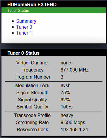

nagle3092 1 Posted October 5, 2017 Author Posted October 5, 2017 (edited) Any connection. When you are remote it can use the mobile transcode profile, if it can direct play it. but as mentioned before, it needs to support the mpegts container in order to be able to direct play it.Thanks for all the answers. When playing a main channel like 4.1, 5.1, 7.1 remotely on the android app it wont transcode at the extend at all but if I pick a lower channel like 4.2, 5.2, 7.3 it will use a transcoding profile on the extend but also has ffmpeg working on the server. Instead of using the mobile profile its using heavy and I am guessing to meet the 2mbps limit I imposed for remote connections its transcoding on the server to bring it even lower instead of just using a lower transcoding profile like mobile or one of the 4 internet settings on the extend. Edited October 15, 2017 by nagle3092
Luke 42243 Posted October 5, 2017 Posted October 5, 2017 Did you check stats for nerds to find out why it is transcoding? The app is requesting roughly 1.5mbps. We have the mobile profile estimated at 2mbps, therefore it is transcoding on Emby Server to make the bitrate fit.
nagle3092 1 Posted October 5, 2017 Author Posted October 5, 2017 Did you check stats for nerds to find out why it is transcoding? The app is requesting roughly 1.5mbps. We have the mobile profile estimated at 2mbps, therefore it is transcoding on Emby Server to make the bitrate fit. Yes the stats for nerds says the media bitrate exceeds the limit but on the extend its using the heavy profile instead of mobile. This only happens on subchannels if I play a main channel it wont kick in at all on the extend.
Luke 42243 Posted October 5, 2017 Posted October 5, 2017 Does it matter which profile is being used at 1.5mbps? Because all of them will transcode at the Emby Server level, doesn't matter if it's pulling mobile, heavy, etc. If the app needs 1.5mbps then it's going to have to transcode the HDHR stream because there is no HDHR profile that can fit under 1.5mbps. Generally speaking when we're going to transcode on emby server, we will take the raw stream from hdhr in order to avoid a double transcode on both emby server and the hdhr. In your case I think you have configured your HDHR to return heavy, so in that scenario emby server thinks it's getting the raw stream but is really getting the heavy transcode. (which is probably fine and won't matter in most situations).
nagle3092 1 Posted October 5, 2017 Author Posted October 5, 2017 Does it matter which profile is being used at 1.5mbps? Because all of them will transcode at the Emby Server level, doesn't matter if it's pulling mobile, heavy, etc. If the app needs 1.5mbps then it's going to have to transcode the HDHR stream because there is no HDHR profile that can fit under 1.5mbps. Generally speaking when we're going to transcode on emby server, we will take the raw stream from hdhr in order to avoid a double transcode on both emby server and the hdhr. In your case I think you have configured your HDHR to return heavy, so in that scenario emby server thinks it's getting the raw stream but is really getting the heavy transcode. (which is probably fine and won't matter in most situations). I am just trying to prevent the double transcoding. I changed the limit to 3mbps for external streams and it is using the heavy profile on the extend and ffmpeg on the server to convert the stream. Since you said the mobile profile was estimated to be 2mbps wouldnt that be the one for the server to use? Stats say media bitrate exeeds limit, under transcoding info the bitrate is listed at 1.3bps.
