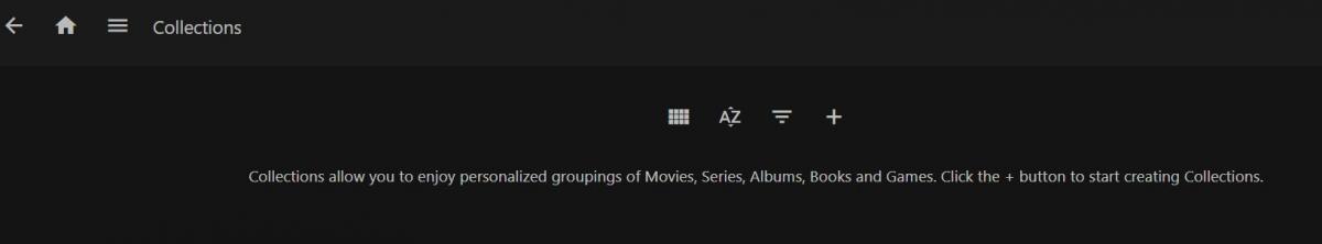

Happy2Play 9802 Posted October 6, 2017 Posted October 6, 2017 The collection.xml in nested folders is the legacy way of doing collections. Looking at the screenshots you provided Legacy collections will not show up in "Collections View" (your second image), only collections made by Emby, those collections reside in \emby-server\data\collections..
