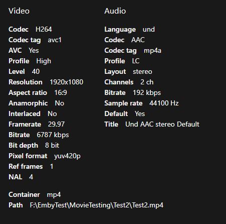

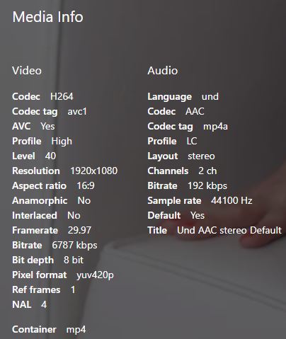

PenkethBoy 2068 Posted October 3, 2017 Author Posted October 3, 2017 (edited) First, compare the media format of your file to the format supported by the Emby app. You can find the media info in the Emby Web Client, at the bottom of the detail page: Where is the list of supported format by Emby APP?? - Found it No subtitles - video quality is on Auto in App and on the server noticed the bit rate is different in the details page and what ffmpeg is returning - not sure if thats significant? Edited October 3, 2017 by PenkethBoy
Happy2Play 9802 Posted October 3, 2017 Posted October 3, 2017 You would have to post the full logs, server and transcode.
PenkethBoy 2068 Posted October 3, 2017 Author Posted October 3, 2017 Ok it matches supported formats i.e. - MP4, AAC

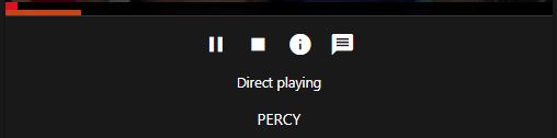

PenkethBoy 2068 Posted October 3, 2017 Author Posted October 3, 2017 Ok put max - bit rate to 1080p - 60MPs Played file and it says in Dashboard its direct playing but its actually transcoding - can see ffmpeg process and transcode log created tried a couple of other files and they do the same I thought it was an easy answer - will raise a separate thread in android mobile sub forum
Guest asrequested Posted October 3, 2017 Posted October 3, 2017 (edited) Post the transcode logs. I'd like to poke around, when I get home. And what is your phones Wi-Fi bandwidth? Edited October 3, 2017 by Doofus
Luke 42203 Posted October 3, 2017 Posted October 3, 2017 The browser video player may have reported an error and therefore the web app automatically switched to a full transcode. when this happens i haven't yet tested the effect on the various reporting mechanisms, e.g. server dashboard, stats for nerds, etc.

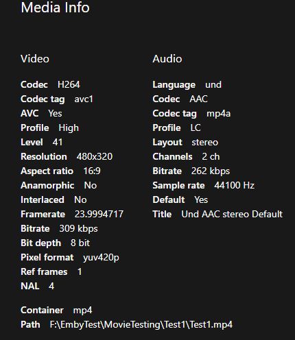

PenkethBoy 2068 Posted October 3, 2017 Author Posted October 3, 2017 (edited) Tested on two different Beta Servers (not netcore) 3.2.33.1 Mobile App on phone is 2.9.61 Bit rate on App set to 4k-120MPs - ie max But transcodes when on Auto as well or any setting it appears Phone is on WIFI - just tested at 24MBps what ever i set the in App bandwidth to it transcodes - even though the dashboard shows as Direct playing? Have tried a low bit rate file and a higher bitrate file Logs [removed] for testing both of above files with trans log files Over to the experts Edited October 4, 2017 by PenkethBoy
