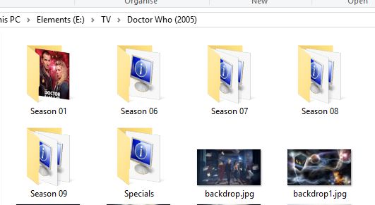

paulsalter 84 Posted October 12, 2017 Posted October 12, 2017 (edited) This is an example, easier to show in pictures I have just added Season 06 of Doctor Who In Explorer In Emby EDIT:This was in reply to another post which has now gone Edited October 12, 2017 by paulsalter
CBers 7542 Posted October 12, 2017 Posted October 12, 2017 That's also dropping the '0' in '06'. I've just added a "Season 6" under Doctor Who and in the web client it shows "Series 6". All of my other new season folders are created via Sonarr, so what's different ?? For example, "Legends of Tomorrow" is in a folder called "Season 3" and Emby says "Season 3".

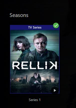

paulsalter 84 Posted October 12, 2017 Posted October 12, 2017 (edited) I have just tested on mine with Rellik, no season.nfo created either Explorer Emby Edited October 12, 2017 by paulsalter
