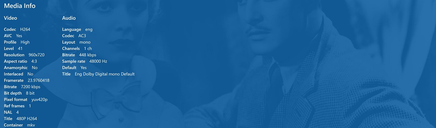

Guest asrequested Posted February 20, 2018 Posted February 20, 2018 (edited) I have a bunch, too. It's the same in 3.2.70.16 I tried refreshing and manually deleted the nfo file. Re-scanned, no change. But yes, it does play, correctly. Edited February 20, 2018 by Doofus
Happy2Play 9814 Posted February 20, 2018 Posted February 20, 2018 I have a bunch, too. It's the same in 3.2.70.16 I tried refreshing and manually deleted the nfo file. Re-scanned, no change. But yes, it does play, correctly. But your example is 960, and Luke state >=1200.
Guest asrequested Posted February 20, 2018 Posted February 20, 2018 But your example is 960, and Luke state >=1200. Yeah, but I also said that I have many, and with different sizes.
Happy2Play 9814 Posted February 20, 2018 Posted February 20, 2018 (edited) @@Luke would have to comment on the1080p threshold as he only mentioned 720p.oops he already did It's only at the point of display so it's not really harming anything. We are considering 1900+ width as 1080p, but I will lower it though in order to handle those 1892 examples. The 1440 one though is unlikely to change. thanks. Edited February 20, 2018 by Happy2Play
Guest asrequested Posted February 20, 2018 Posted February 20, 2018 @@Luke would have to comment on the1080p threshold as he only mentioned 720p. The original posts are 1080 being reported as 720. I was just showing that it happens with multiple sizes. Using the width just doesn't work. And the cover art is wrong, too

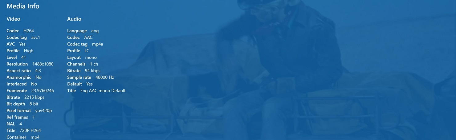

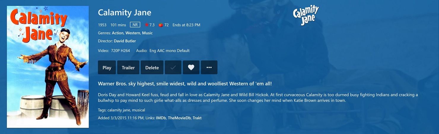

quorn23 13 Posted January 5, 2021 Posted January 5, 2021 (edited) Found this topic searching for it. It even says 1080p HEVC, but the Thumbnails keeps being generated as 720P Is there a way to overwrite this? Or is it a technical issue of Emby? Edit: Became aware that's probably an issue with the CoverArt Plugin, as the resolution sticker is not vanilla emby. Will search for the thread for that plugin. Edited January 5, 2021 by quorn23
Carlo 4561 Posted January 6, 2021 Posted January 6, 2021 These can both be correct depending on the actual resolution. If only displaying the Width and this wasn't cropped then it will show 1080. If however you're looking at the height and width and the height is cropped and not big enough to be considered 1080 then you'll get 720. So in your file you have 1480x1080 which is quite a bit smaller than 1920 x 1080 which is the box size for a 1080 full HD video. So it's 720 or better but not 1080 box size.
