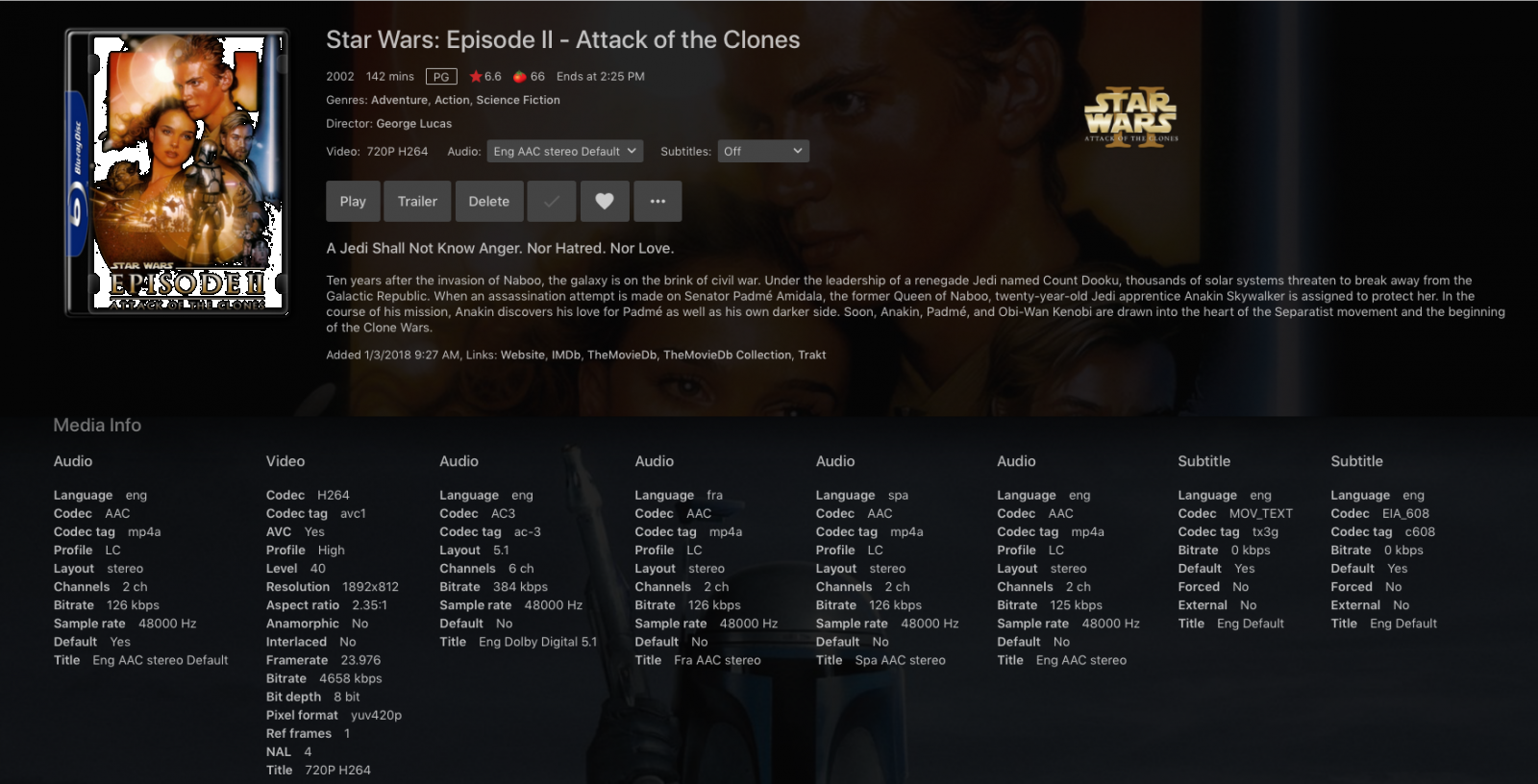

mbnwa 49 Posted January 3, 2018 Posted January 3, 2018 (edited) I am also seeing this issue where 1080p content is showing up on the library page and movie stats page as 720p vs 1080p I have about 70-80 movies that are like this. Edited January 3, 2018 by mbnwa
Luke 42266 Posted January 3, 2018 Posted January 3, 2018 It's only at the point of display so it's not really harming anything. We are considering 1900+ width as 1080p, but I will lower it though in order to handle those 1892 examples. The 1440 one though is unlikely to change. thanks.

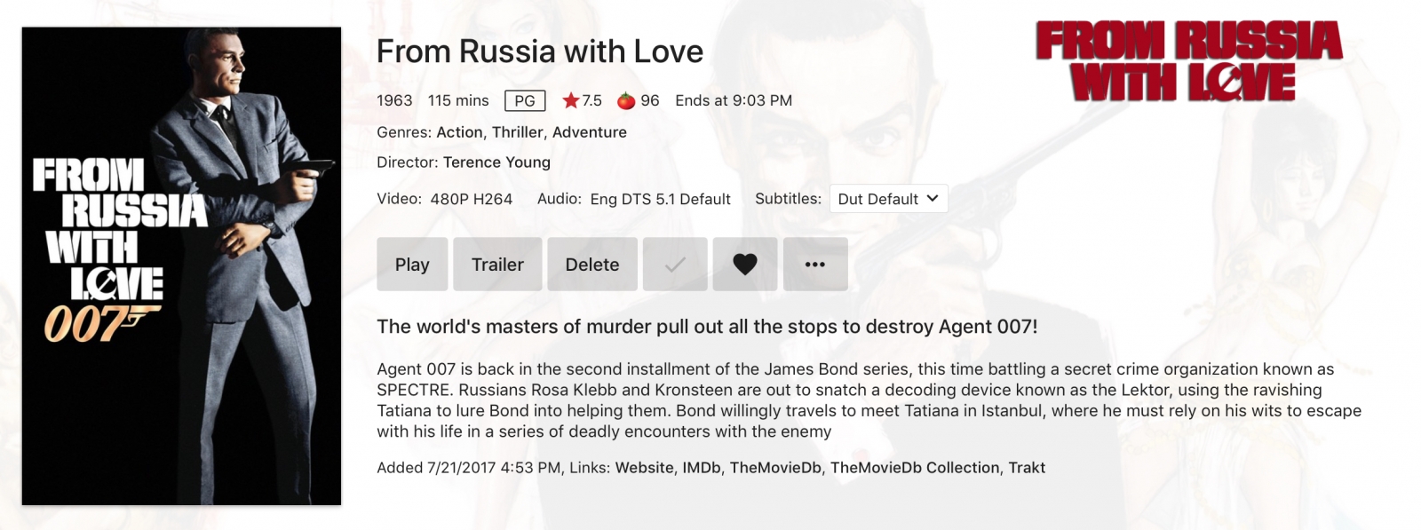

Hoosiers317 18 Posted February 20, 2018 Posted February 20, 2018 Any updates on this? I have about 24-25 720p films showing up as 480p. Thanks!
Luke 42266 Posted February 20, 2018 Posted February 20, 2018 Any updates on this? I have about 24-25 720p films showing up as 480p. Thanks! Where are you seeing this? can you give an example? thanks.

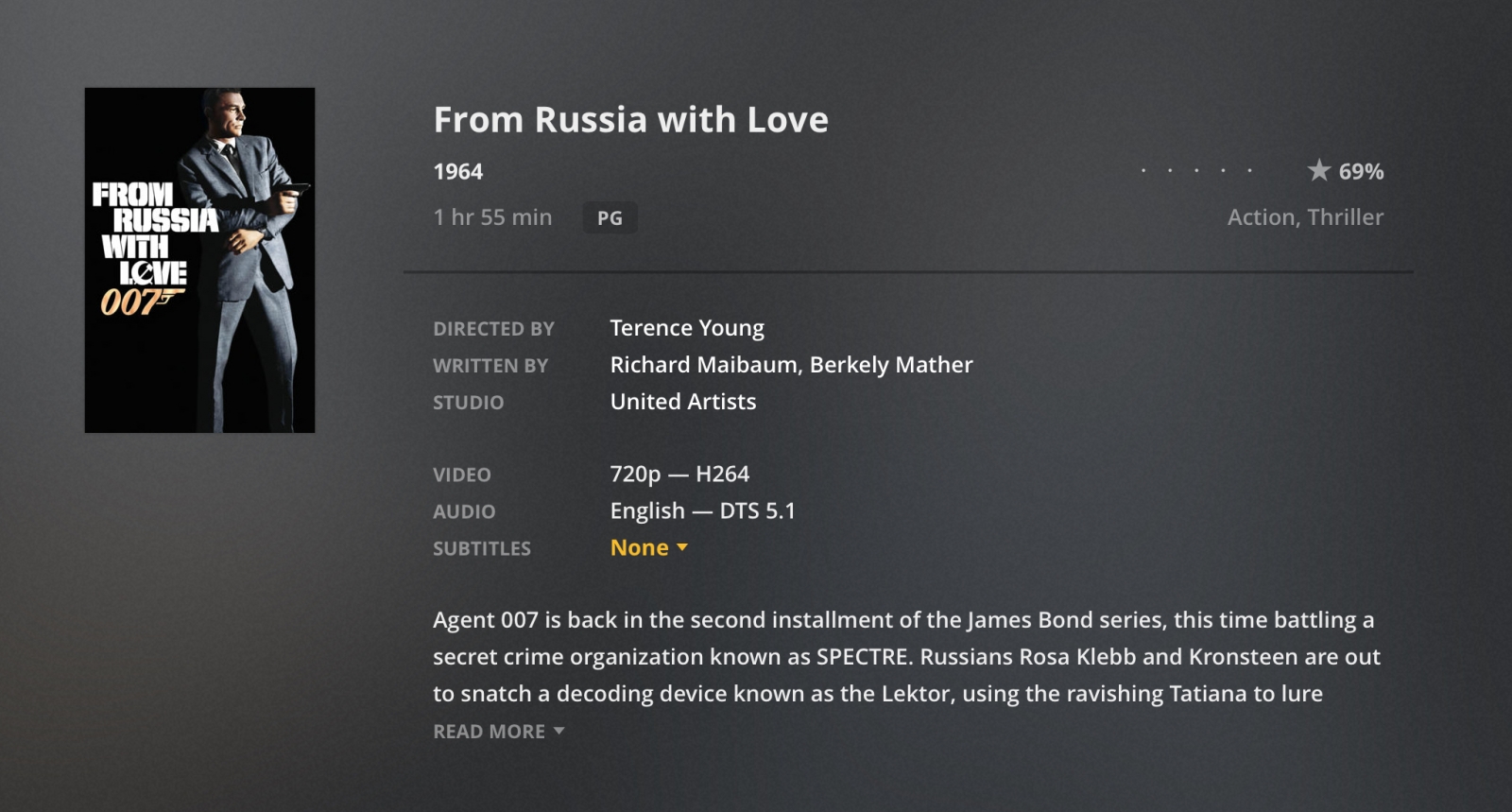

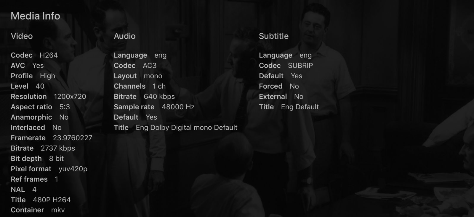

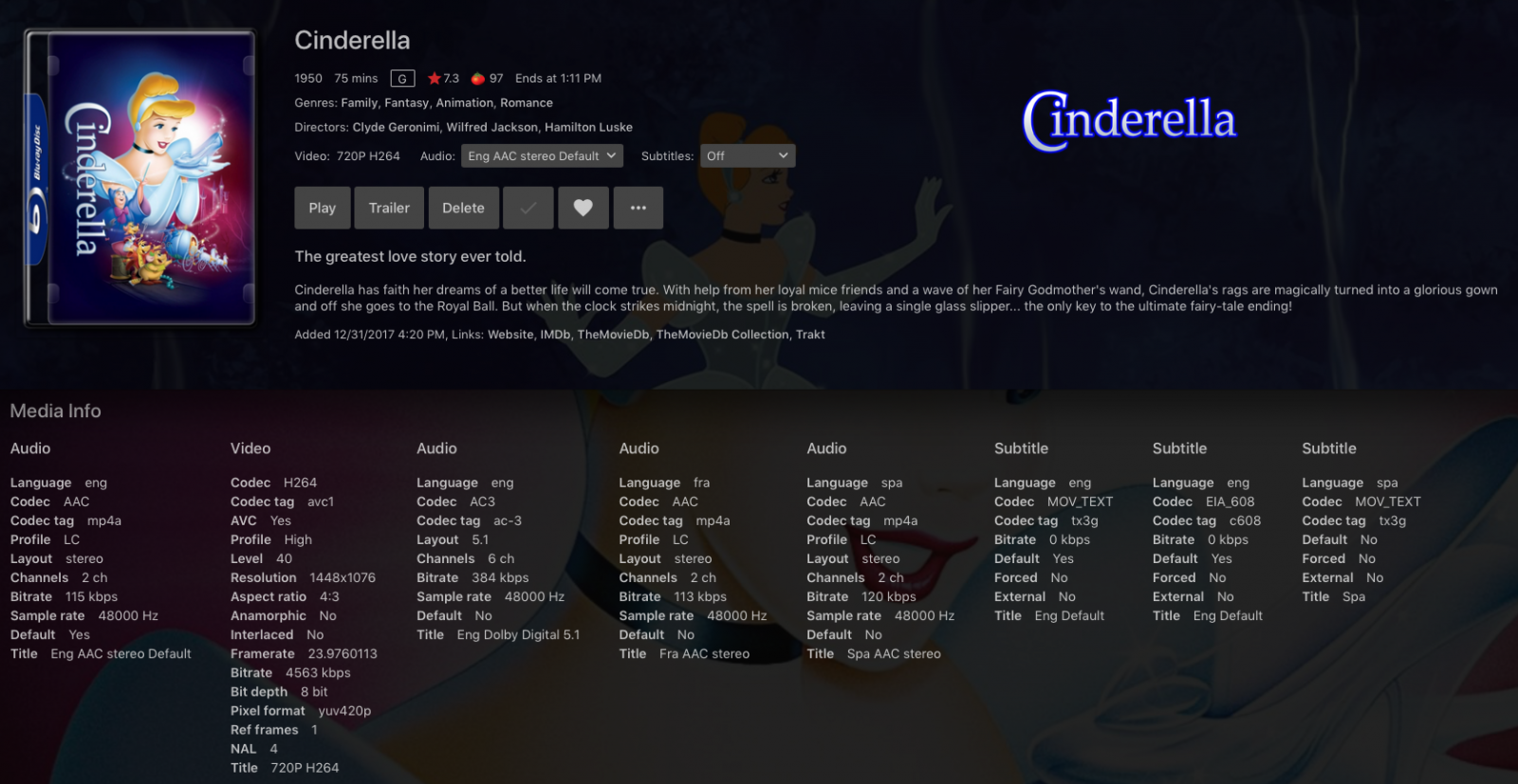

Hoosiers317 18 Posted February 20, 2018 Posted February 20, 2018 Where are you seeing this? can you give an example? thanks. Sure, here you go: Now here is the same movie in Plex, showing correctly as 720p:

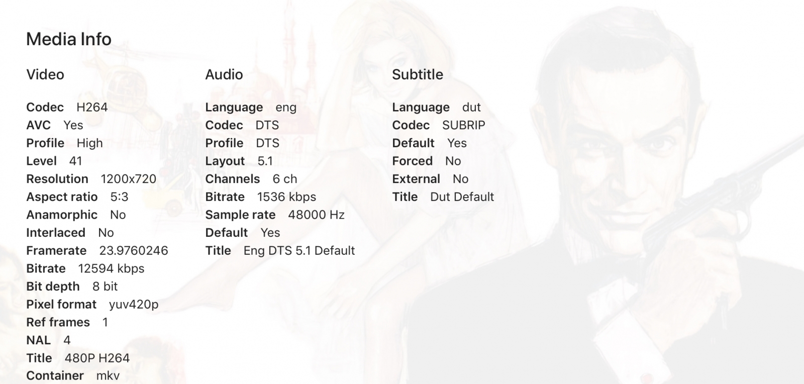

Hoosiers317 18 Posted February 20, 2018 Posted February 20, 2018 What version of Emby Server? Version 3.2.70.0 on MacOS. I had the same problem with the last release as well. Thank you for your help...you're a one man Army!
Luke 42266 Posted February 20, 2018 Posted February 20, 2018 Then i would try again with the next release because I can see we're already checking for >= 1200 on 720p. Thanks.
