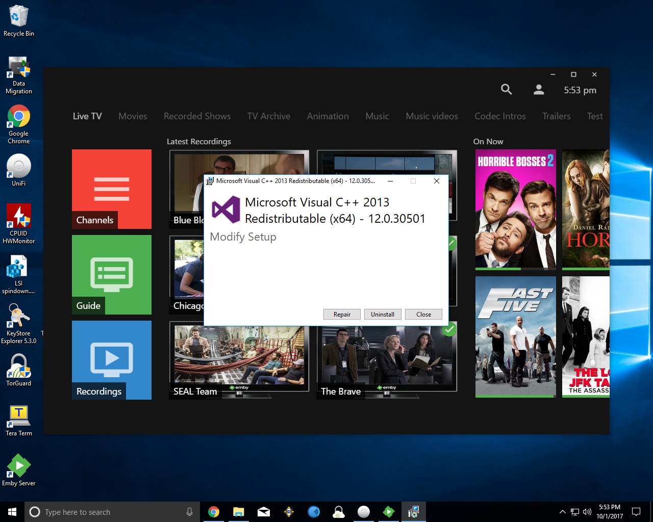

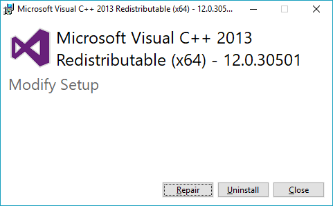

Rumbaar 13 Posted September 29, 2017 Posted September 29, 2017 (edited) Not sure when the update to 2.8.6 was pushed out, but now my EMBY theater doesn't play content and when it starts it tries to run the following I've tried Repair. No success. I've tried close, no success. I've uninstalled EMBY Theater and reinstall, no success. I've tried running EMBY Theater as Administrator, no success. There were, to my knowledge, no other changes to my media PC prior or during this time. It also doesn't exit properly and has to be killed off in Task Manager. This is the device that is running the EMBY server. As a last resort, I even tried to install the Windows Store version. But it seems to fail to see it's connected to a Premiere EMBY server and wont play any content due to restrictions?? I'm sure I don't have that same issue on remote clients using the Win Store app. I've just tried the repair once again, and noticed it's installing a different version than the dialog box? 12.0.21005 ? Now it's trying to install 14.0.23026? Without success. Okay which version do I need to run Theater? Two have installed today it seems. Edited September 30, 2017 by Rumbaar

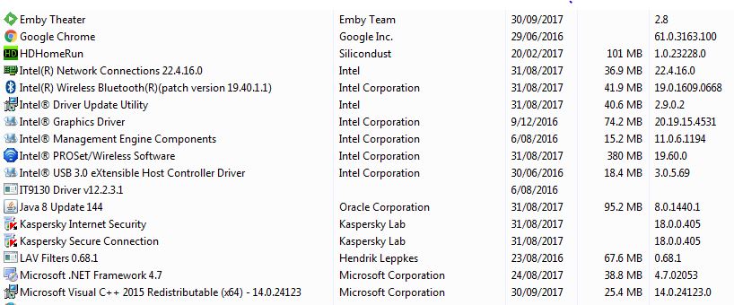

Azzablitz 1 Posted September 30, 2017 Posted September 30, 2017 Hi i am experiencing the same issue, it only started in the past couple of days. I have tried to uninstall the current c++ 2015 package (14.xxx) and downloaded the latest, no change the message still comes up when ET launches. I uninstalled ET and installed again the issue is still there. Running ET 2.8.6 on Win 7 pro N on a I3 NUC pointing to Emby server latest version. I have attached screen shots and logs from today.I also had what Rumbaar had seen where it then tried to install Ver 12 after the pc rebooted and ET opened. Let me know if you need anymore happy to help troubleshoot. Thanks MBClassic-3092016a3bfc7e6f9604cdf9c16a4140fe50537.log MBClassic-30920161ad3debae46d4c6e8dd63c50cf8203d0.log

Rumbaar 13 Posted September 30, 2017 Author Posted September 30, 2017 (edited) I downloaded and installed over the current installation from the website. It still asks to repair the 12.0.30501(12.0.23026) each time it starts. But it plays the media once I do that and progress into the application. Should I do something, like full uninstall the application and the C++ distribution? It also hasn't been an issue on other machines in my network that has ET installed on. I even fresh installed onto a new laptop and that hasn't been an issue. Only my main media machine. Edited September 30, 2017 by Rumbaar

inzombyac 69 Posted October 3, 2017 Posted October 3, 2017 I was getting this too. I had to do manual cleanup of the Visual C++ versions. See the post here: https://emby.media/community/index.php?/topic/48763-every-time-i-launch-emby-microsoft-visual-c-2015-installer-window-pops-up/&do=findComment&comment=494277
testor358 0 Posted October 3, 2017 Posted October 3, 2017 I feel like we're past the point of really helping folks on this thread but there is one more way to fix this problem. Simply take note of which versions of MS Visual C++ are throwing the error when you start Emby Theater. In my case it was 2015 and 2013. I remembered seeing this before on another system/application and the fix was to install the x86 version of C++ that was repeatedly trying to install. So after searching for and installing the 2013 and 2015 x86 C++ redist files all is working just fine with 2.8.6. I have no idea why that works. Now I will upgrade to 2.9.2.
mentasm 43 Posted October 4, 2017 Posted October 4, 2017 To fix mine I had to install x86 C++ 2015. Then I had to download 2.9.2 from the site. The first install attempt failed until I removed the existing system.old folder from the install directory
