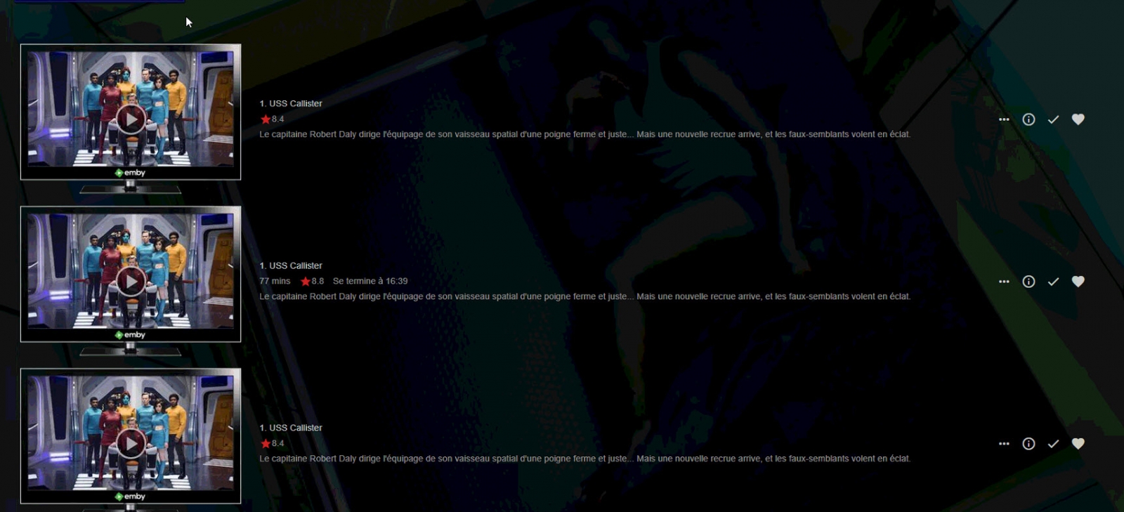

Vidarr 10 Posted April 24, 2018 Posted April 24, 2018 (edited) Hello @@Luke Btw the collection folder is really nice but i have some issue since the the update, some folders have 15 entry for the same video. for example look below : Edited April 25, 2018 by Vidarr

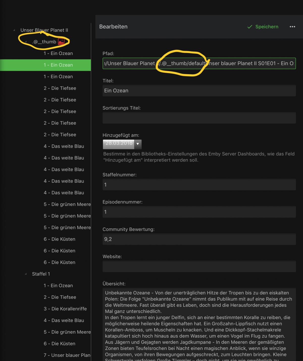

LukeNukem 1 Posted April 24, 2018 Posted April 24, 2018 I‘ve got the same problem. Some episodes have 4-6 entries for one file. The metadata manager shows eintries for subfolder „.@__thumb“ and „default“ before filename. Can give you some screenshots later.
Vidarr 10 Posted April 25, 2018 Posted April 25, 2018 The screenshot in my post below and it's like that in many folders as Lukenukem said he is detecting @thumb and stuff.

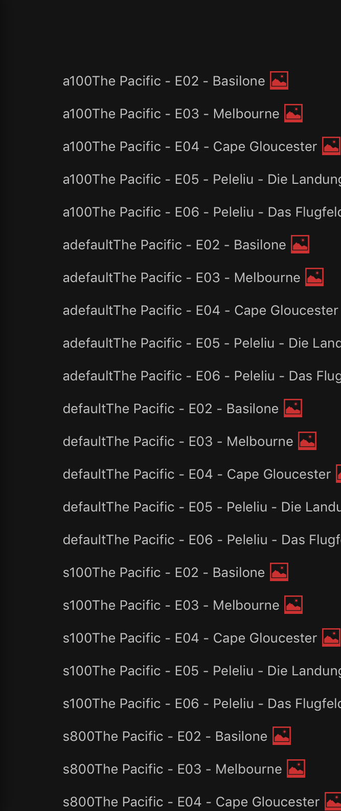

LukeNukem 1 Posted April 25, 2018 Posted April 25, 2018 (edited) Here is a screenshot from metadata manager. The other files have adefault, a100, s100, s800, instead of „default“ in filename. When I delete the strange named media Emby Server is not responding any more and I have to restart the QNAP. Edit: Second Screenshot Edited April 25, 2018 by LukeNukem

OneCD 10 Posted April 25, 2018 Posted April 25, 2018 The QTS multimedia scanner has been creating those files for years. Despite everyone's best efforts to get it to stop. 1
LukeNukem 1 Posted April 26, 2018 Posted April 26, 2018 I'm new to qnap, so I didn't know that, thanks. Emby wasn't showing the folders with older versions. I only activated multimedia scanning for my photos, does anybody know why it does create the folders in some of my video folders anyway? 1
PenkethBoy 2068 Posted April 26, 2018 Posted April 26, 2018 you can get them to stop being produced easy enough - turn off thumb nail creation in file manager and turn off the QNAP multimedia scanner as @@OneCD said (Welcome OneCd still behind the sofa i see!) the tricky bit (for the average user) is deleting them as they are hidden by the system by default 2
OneCD 10 Posted April 26, 2018 Posted April 26, 2018 (Welcome OneCd still behind the sofa i see!) Hey Tim. Yes, my own small homage to Douglas Adams. 1
LukeNukem 1 Posted April 26, 2018 Posted April 26, 2018 you can get them to stop being produced easy enough - turn off thumb nail creation in file manager and turn off the QNAP multimedia scanner as @@OneCD said (Welcome OneCd still behind the sofa i see!) the tricky bit (for the average user) is deleting them as they are hidden by the system by default thanks for your reply. i´ve disabled thumbnail creation for the video folders via file manager at first use. I enabled multimedia scanner because of the QNAP Photo Station but only added my photos as media folder, so thumbnails shouldn´t be created in video folders? Well seems to be a qts error and not an emby error, although it´s strange that they weren´t displayed in older emby version. I´ll try to delete the .@_thumb folders via ssh and hope they won´t be generated again. maybe I should disable Photo Station and multimedia scanner completely and use emby for photos too ;-)
PenkethBoy 2068 Posted April 26, 2018 Posted April 26, 2018 to stop the creation - i turned off all the stations and media scanning
