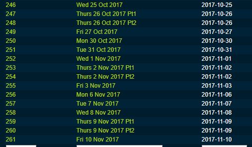

Spaceboy 2573 Posted November 5, 2017 Author Posted November 5, 2017 have you checked the guide data? we name the files with exactly the information that is in the guide data. thanks. well obviously it is too late to look at last thursdays episodes but next week there are two episodes on Thursday again. the episodes have different descriptions but there are no episode and series numbers evident from what i see in emby. but they are there when they appear in the recording library. this is schedules direct epg.
paulsalter 84 Posted November 5, 2017 Posted November 5, 2017 Same with any date based shows that air more than one episode daily (eg Coronation Street airs 2 Eps on a Mon/Wed/Fri) Looks like when it does a match with tvdb, it just picks up the first occurrence of the date and uses those details Episode numbers are not used by the broadcaster so the only data we have is aired date Emmerdale on tvdb 1
