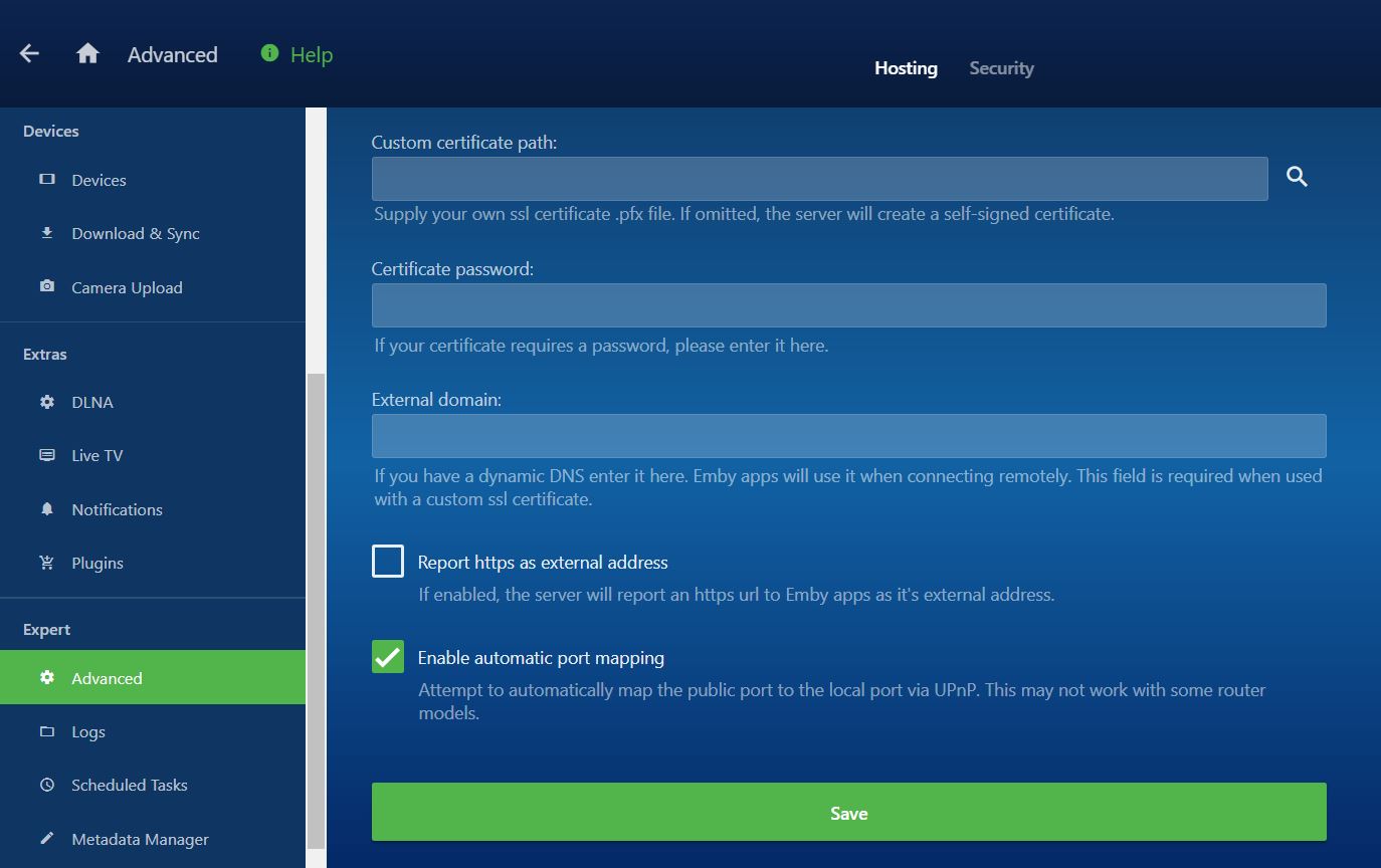

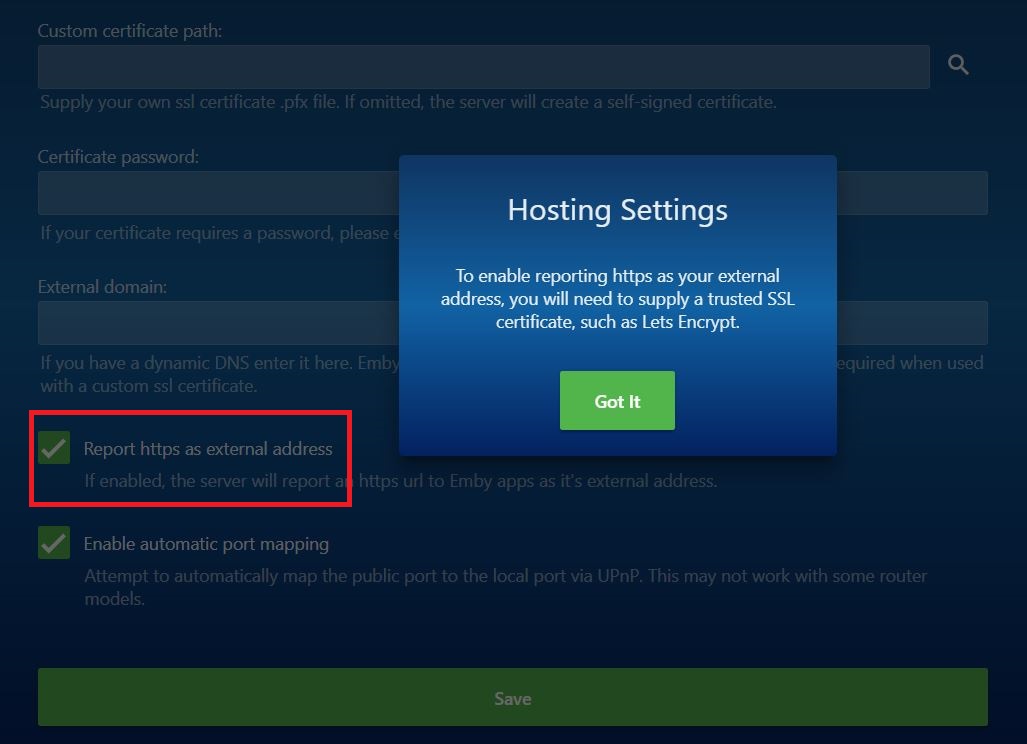

ebr 16958 Posted September 24, 2017 Posted September 24, 2017 Hi. In the screen shot above it is the "Report https as external address" that you would want to enable. Automatic port mapping is not required. However, be aware that you probably will need a true certificate as opposed to a self signed one for all apps to work properly.
iamspartacus 40 Posted September 24, 2017 Author Posted September 24, 2017 Hi. In the screen shot above it is the "Report https as external address" that you would want to enable. Automatic port mapping is not required. However, be aware that you probably will need a true certificate as opposed to a self signed one for all apps to work properly. Yes, this I just found out. I have created a new letsencrypt cert for emby.mydomain.com. However, do you have any guides on how to create a .pfx file for this cert so I can import it into Emby?
