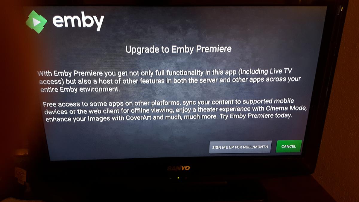

riccote 2 Posted September 23, 2017 Posted September 23, 2017 (edited) I have Emby Premiere and I unlocked the Emby app on Amazon. I included a picture of the screen I get when trying to watch live TV. Using the Emby plugin(Version 3.2.30.0) on FreeNAS. Edited September 24, 2017 by riccote

ebr 16337 Posted September 24, 2017 Posted September 24, 2017 I have Emby Premiere and I unlocked the Emby app on Amazon. I included a picture of the screen I get when trying to watch live TV. If you have Premiere, you don't need to unlock the app. Are you connected to your server and the key is installed properly on it when this happens?
riccote 2 Posted September 24, 2017 Posted September 24, 2017 (edited) If you have Premiere, you don't need to unlock the app. Are you connected to your server and the key is installed properly on it when this happens? I am connected remotely, I can play media from the server(FreeNAS plugin). Edited September 24, 2017 by riccote
