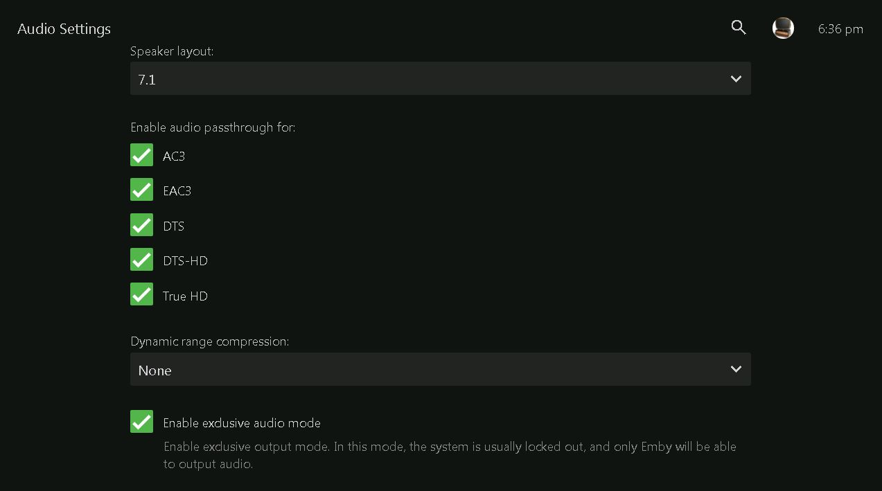

Sammy 791 Posted September 15, 2017 Posted September 15, 2017 Last week I had a failure of my AMD Radeon HD7850 GPU and am currently using the onboard intel HD4600 iGPU. I had to disable madVR (until I tune it down from Jinc, etc to avoid stutter) and am currently using the ET video renderer with some "mild" settings for stutter free playback. With this I noticed that my AVR 2312ci no says "Multi-Channel Stereo" instead of say "DTS Master" for example. What settings to make to have the DAC in the AVR do the decoding rather than the DAC in the CPU? TIA
Sammy 791 Posted September 18, 2017 Author Posted September 18, 2017 How to ensure the audio is decoded by the AVR and not the HTPC? In other words, where's the passthrough checkbox in ET?

Sammy 791 Posted September 19, 2017 Author Posted September 19, 2017 No. And my Denon AVR2312ci most definitely supports more than this.. If I deselect Passthrough in ET I get Stereo on my AVR?
Luke 42243 Posted September 19, 2017 Posted September 19, 2017 If you deselect passthrough then of course you get stereo, yes. Is there a problem that you're experiencing?
Guest asrequested Posted September 19, 2017 Posted September 19, 2017 Enabling pass-through just means the audio is bitstreamed to your AVR and the AVR will perform the DAC. That is the correct behavior.

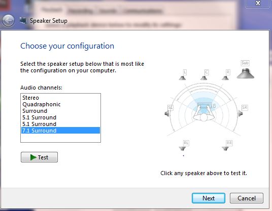

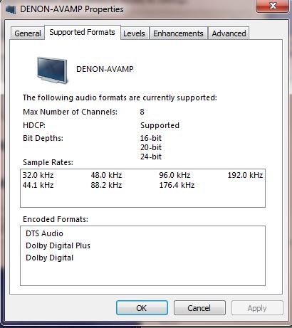

Sammy 791 Posted September 19, 2017 Author Posted September 19, 2017 When I enable Passthrough, I get Multi-Channel Stereo, Not Passed through audio which then would display DTS-Master or Dobly TruHD on the front panel of the AVR. This is not what is happening. It seems that if I disable passthrough then the decoder in the HTPC should be sending Multi-Channel Audio to the AVR. What is odd is that my AVR supports the (then) current formats (not Atmos) and even can use front height speakers in its own matrix output but if you see the Sound Properties > Supported Formats it only says it supports the Lossy audio. In addition to all this, I'm having issues with some movies not properly playing back the audio tracks. It sounds as if it is muted by 25 dB relative to the rest of the audio output. This is not occurring on all movies and it is not relative to any specific audio format as I've tested quite a few different ones. When playing back on Roku the audio is there and the dialog is not dropped output; it even bitstreams dts but not dts-MA. The issue with Roku is that it plays back 24p content at 60p and it doesn't show full range RGB so it looks washed out too.

Sammy 791 Posted September 20, 2017 Author Posted September 20, 2017 Have you tried testing passthrough with standalone mpv or another player like hpc-hc? I have not. I am still just starting my testing. I get maybe an hour in the wee hours of the morning to do this stuff. I am also going to rule in or out issues with the iGPU in the HTPC by putting a disk with a 7.1 lossless track in the Blu-Ray Player and see what happens. Hope it still works to play Blu-ray disks as I only use it to stream 3D content from Vudu at this point.. I tried this this morning. On MPC-HC my AVR says dts Surround (but not dts-Master) so MPC-HC is passing through the audio track best it can given that for whatever reason the lossless tracks are not available in the Control Panel > Sound settings page. That's another issue to tackle I suppose but ET is still decoding and sending Multi-Channel Stereo. The good thing here is that it is sending the PCM 7.1 track to the AVR. I have also seen but still need to double-check / verify that when the track is lossy, such as dts-Core the AVR shows dts Surround on the display when using the mpv player. It would seem that the mpv player is decoding when the system sound settings does not recognize the format and doing pass through when it does. This is probably why, when unchecking the lossless dts-MA and Dolby TruHD in the ET settings, it sent stereo but that is something for the experts here to answer.. as they know what mpv is supposed to do in these situations.
