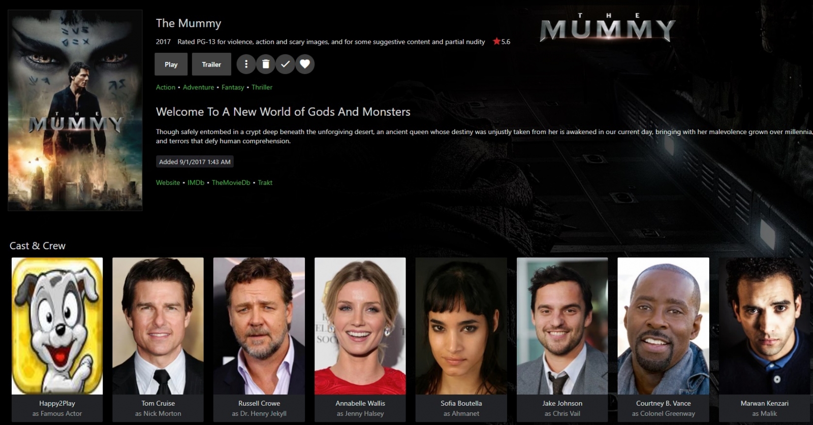

Happy2Play 9802 Posted September 12, 2017 Posted September 12, 2017 (edited) Ideally you add the persion to where they need to be (series, season, episode, or movie) as there role, then upload there image as needed. Like me adding my self to this movie But if I got to my details page and edit the name in any way I will be removed as there is now a mismatch between movie and person. Make since? Edited September 12, 2017 by Happy2Play

Happy2Play 9802 Posted September 12, 2017 Posted September 12, 2017 So cast is not relational, as in no cascading update? I cheated and moved myself to be first in nfo after adding myself.
