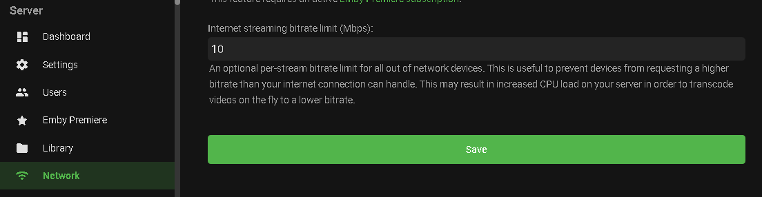

Carlo 4561 Posted July 23, 2020 Posted July 23, 2020 1 hour ago, Painkiller8818 said: Since this is from 2017 is there now a global upload limiter? I can't find it, maybe i missed a thing. Thanks Do you mean this setting on the Network menu?
Painkiller88 250 Posted July 23, 2020 Posted July 23, 2020 2 minutes ago, cayars said: Do you mean this setting on the Network menu? Yeah not exactly because this is just the per stream limit, i am looking for a global maximum upload limit for all users. EG: if i have 50MBit up i want to limit to 45MBit for all users
Carlo 4561 Posted July 23, 2020 Posted July 23, 2020 Got ya, like a MAX GLOBAL BANDWIDTH AVAILABLE type setting. Nothing like that available that I'm aware of. I'm not sure how that would work. If you're first user starts playing something via Direct Play and uses 30Mbit then you'd have 15Mb left for all other users. With the above setting you could set it to 10Mbit for example and likely be able to serve up 5 or more clients with each getting decent bandwidth.
