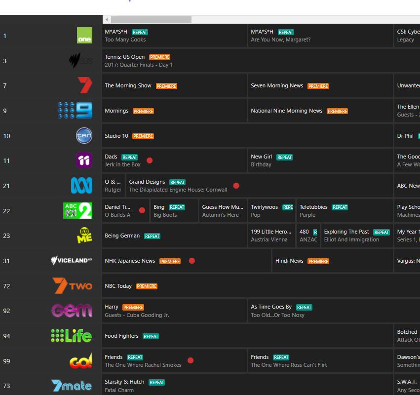

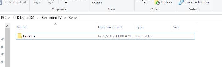

vaise 340 Posted September 6, 2017 Posted September 6, 2017 (edited) So I have a small window between the wifes recordings to again try and move to native Emby and away from nextPVR. Prep _ Removed plugin, restarted, added 2 of my 3 HDHD3-EU tuners (giving 4 tuners total), Added XML guide, restarted. Mapped channels, The excluded about 30 channels, leaving the 15 I need. That process takes about 30 minutes to setup for this test. Test - It was 10:45, I set 5 things to record in the guide. 4 should fire at 11:00, 1 at 11:05. Due to the nature of the TV stations here, these 5 shows should use 4 tuners (and two were from the same 'provider'. Waited till 11:00 - see in log at 11:00 - 4 fires (correct), only one TV show is recorded (friends) - not correct At 11:05, see in log anther fire - but again nothing new in the recordedTv folder - just friends still. Tuners show 2 of the 4 are in use. There should be 4 in use at this stage. Logs are attached. go to 11:00 and 11:05 to see the activity. Screen shots of all I said above are attached. I have to set back to normal NextPVR mode withing 5 hours so I will re-do this test again - but it is not stable enough for leaving it like this if i dont want to get divorced from the wife. server-63640289901.txt Edited September 6, 2017 by vaise

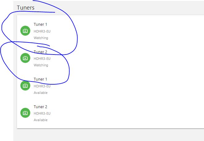

vaise 340 Posted September 6, 2017 Author Posted September 6, 2017 (edited) I finally saw two active recordings for the first time in the console - alas both shows had finished a while ago- also strange - all 4 tuners said 'watching'. Restarted the server again, all clear. Flagged 5 shows to record - 2 at 2:30, 2 and 2:45 and 1 at 2:50 - should use all 4 tuners. Just one show kicked off at 14:30 - nothing in active recordings. tuners say 4 in use - so I guess they did not clear. I am bailing on this test now - it is all just too hard for something that should just work. I cant see how others have it working with the old HDHR Dual tuners (i mean really old). My system is I7, all cabled Ethernet, GB switches but at the end of the day nextPVR works - so it cant be the tech. As a side now - Plex recorded TV also worked fine - I paid for a month to test that when it was first released a while back. Edited September 6, 2017 by vaise

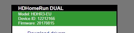

ShotToTheDome 7 Posted September 6, 2017 Posted September 6, 2017 (edited) Do you have most recent beta firmware on them? My two HDHR-3US are working fine in Emby. I did run a hdhomerun setup channel scan first on windows and made sure it synced up to my.hdhomerun.com (you'll see the right channel count reflected). My firmware is 20170815 I'm running mine on linux debian 8 Edited September 6, 2017 by ShotToTheDome
vaise 340 Posted September 6, 2017 Author Posted September 6, 2017 Hi, I updated to the required beta when this first came out, since then, there has been a real release which I updated them all to.
