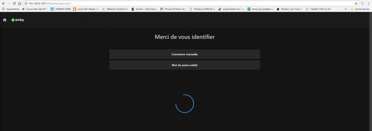

freeflight29 2 Posted December 4, 2017 Posted December 4, 2017 (edited) Can you reboot the device, then run the server? still stuck on the login page. I can't do anything..... server-63648024600.txt Edited December 4, 2017 by freeflight29
