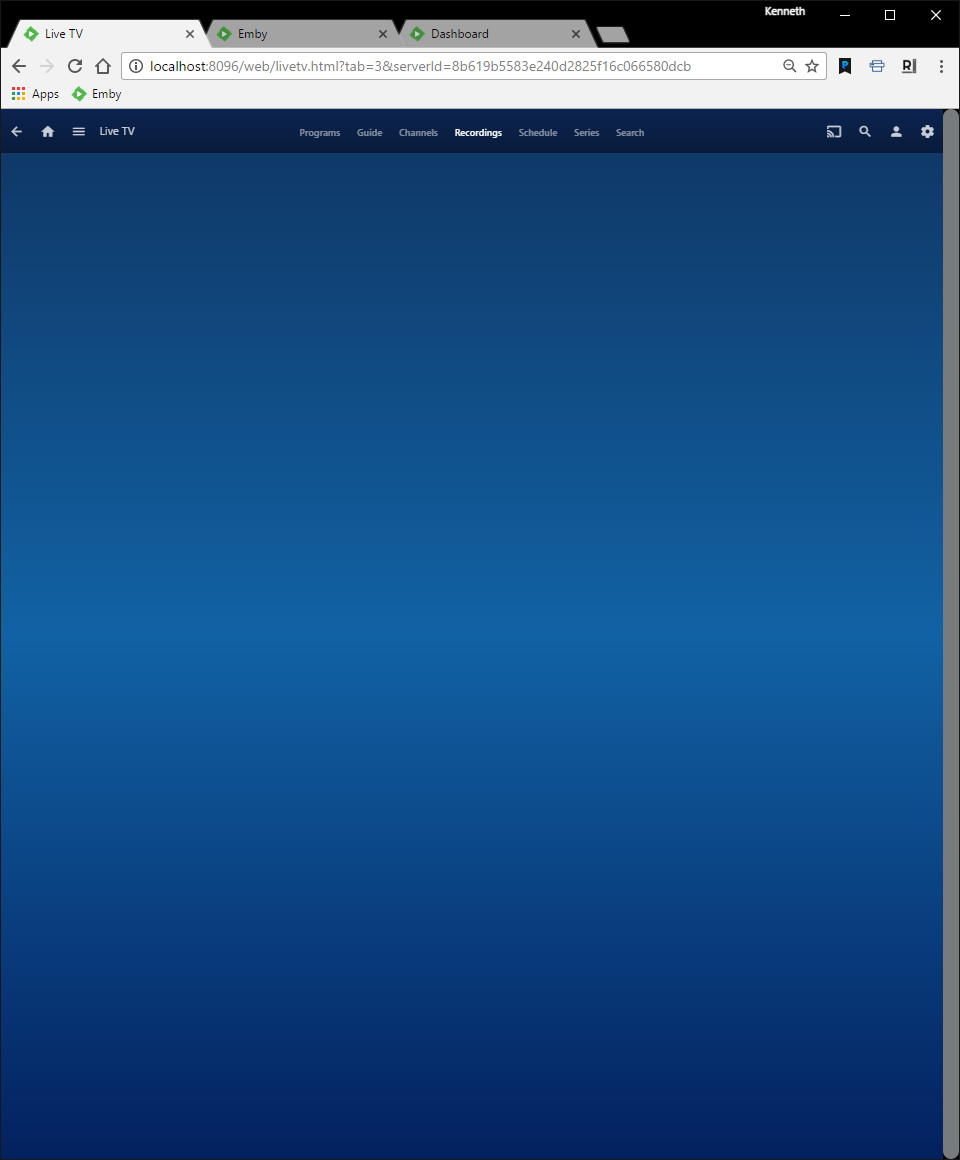

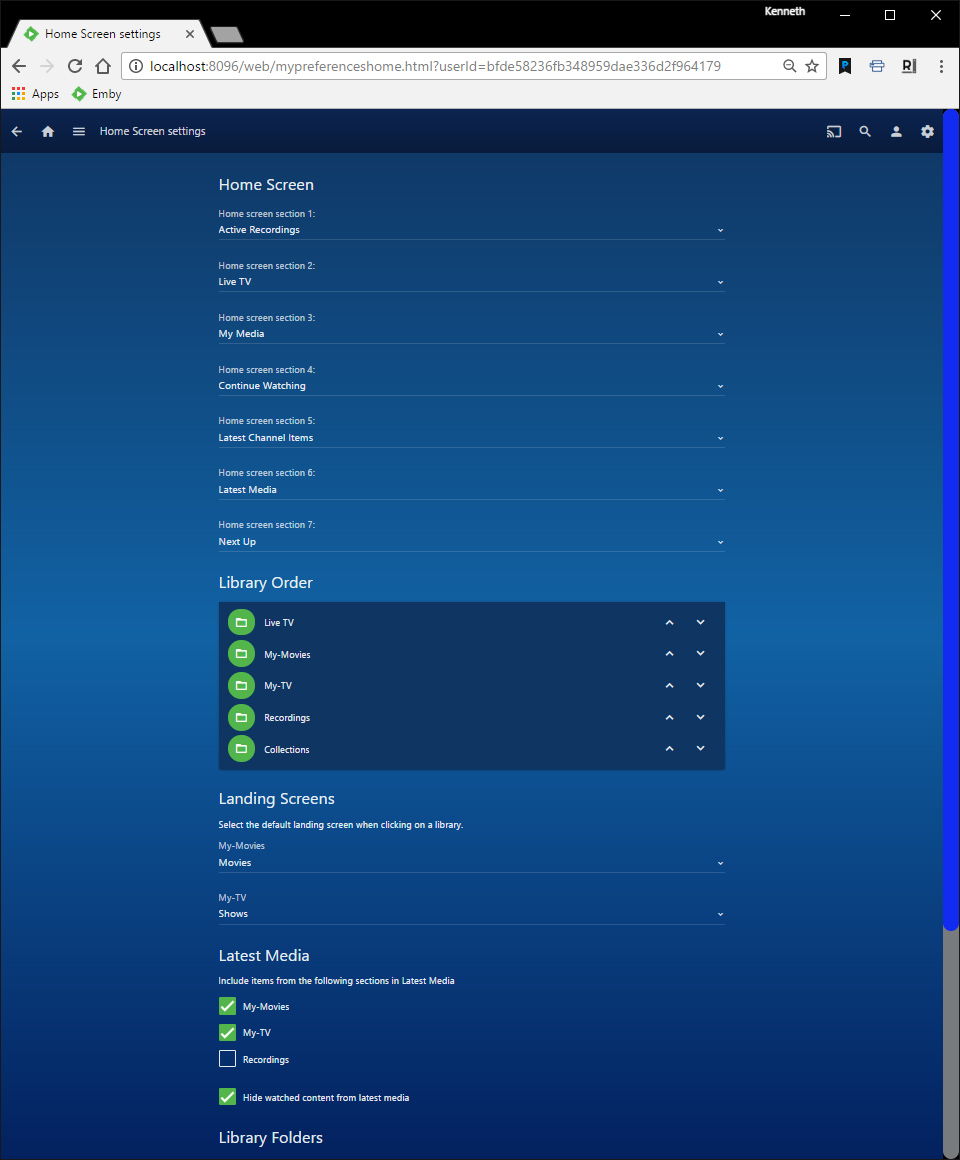

kanipek 230 Posted August 31, 2017 Posted August 31, 2017 I am using 3.2.30 and I have no indication of Active Recording(s) anywhere. Used to see these on the schedule page when they were active. I have "Active Recordings" set for the first position on my home screen and it never shows up. Also I have a recording on the Recordings tab/page from last week listed as active - tried canceling. No other recording show up on that tab/page. Attaching a server log during an active recording. Recording started @4:51pm Eastern and 4:55pm Eastern. Tried with Chrome and Microsoft Edge. Thanks for reading and any help. server-63639767270.txt

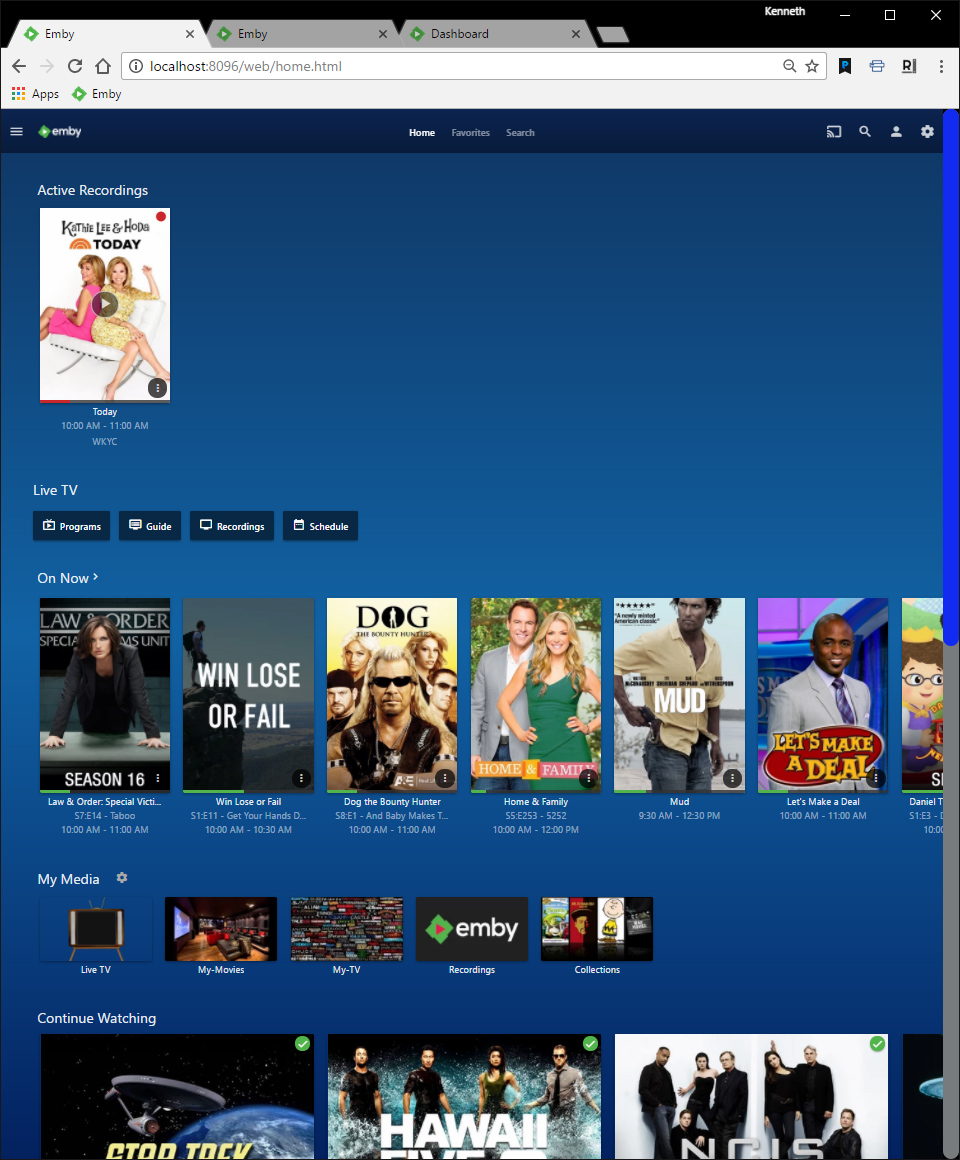

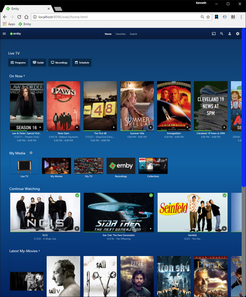

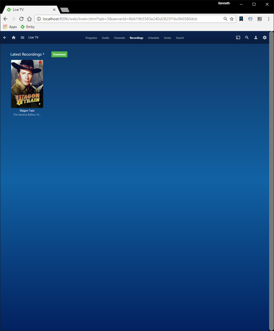

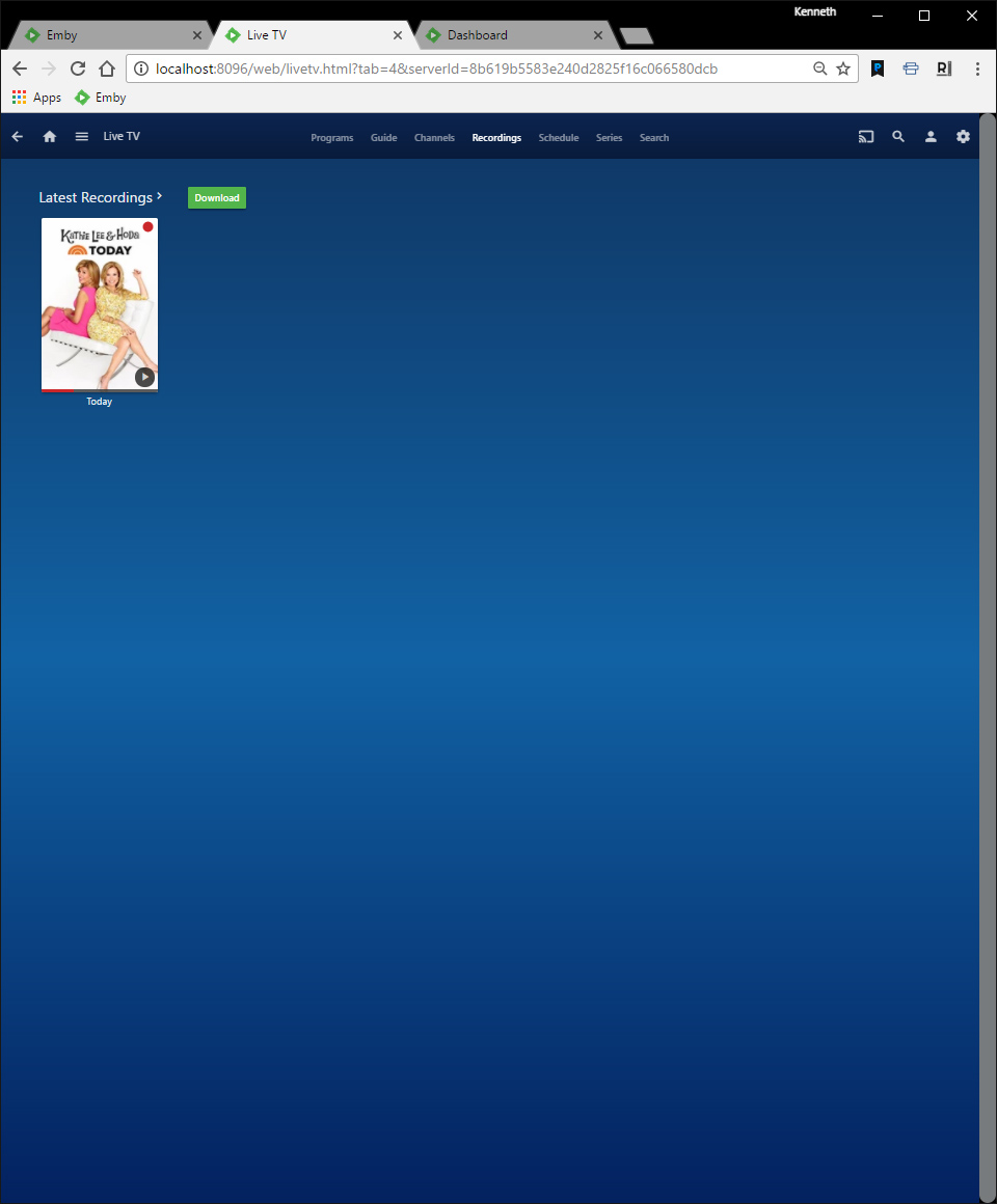

kanipek 230 Posted August 31, 2017 Posted August 31, 2017 Why do you feel that you can't find active recordings? Because as I explained in my post - I have "Active Recordings" set for the first position on my home screen and it never shows up. I have tried rebooting, restarting. Tried changing the order items are displayed. Can't find any indications that active recordings are happening. Attaching screenshots to help clarify what I am seeing. That recording listed under latest recordings happened on August 27th can't get rid of it - might be related to the problem? I have recordings happening as I post this.

kanipek 230 Posted September 1, 2017 Posted September 1, 2017 Doing a little troubleshooting. Using 3.2.28 everything is good. Using 3.2.30 no Active Recording(s) found anywhere - even though they are occurring. See Screenshots. Thanks for reading and any help! 1

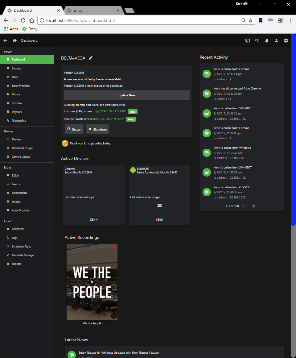

kanipek 230 Posted September 1, 2017 Posted September 1, 2017 What about on the server dashboard front page? We are starting to blend in active recordings with your normal content so they should just appear wherever they belong as soon as they start recording (like in latest recordings or the show listing itself). Active Recordings appear on the Dashboard for 3.2.28. Not 3.2.30. See screenshots.

kanipek 230 Posted October 12, 2017 Posted October 12, 2017 Okay this missing active recordings problem is driving me nuts. Windows 7 it started. Windows 10 clean install it still continues. I know I must be in the minority or possibly even alone. Can anyone please offer me some help? I am attaching a server log for a time when Wagon Train was recorded, TJ Hooker also began during this time. No Active recording listed on any page including the dash. I am willing to do whatever is necessary to solve this issue. server-63643420333.txt
