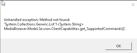

Scott D 69 Posted August 27, 2017 Posted August 27, 2017 I just completed the update to 3.2.29.0. Now when opening a browser to configure the server I am getting the error: See .jpg file Attached is the log file along with the unhandled exception error log. Once this error occurs, the server will shut down and requires a manual restart. Please advise if there is any additional information needed. Seems to happen even if not opening a browser. It just takes a few minutes to occur. server-63639430092.txt unhandled_7eda1194-06e2-4817-8fca-f901a03bbc01.txt
Luke 42203 Posted August 27, 2017 Posted August 27, 2017 Remove the messenger plugin. @@chef fyi this will need an update. thanks. 1
Scott D 69 Posted August 27, 2017 Posted August 27, 2017 That seems to have solved the problem. I will watch it and let you know if it reoccurs. Thanks for the quick response.

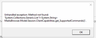

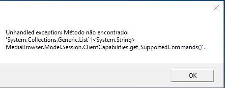

andersonrs45 3 Posted August 27, 2017 Posted August 27, 2017 I updated the latest version of Emby Server (3.2.29.0), and this error is now appearing I updated the latest version of Emby Server (3.2.29.0), and this error is now appearing I updated the latest version of Emby Server (3.2.29.0), and this error is now appearing If I close this error window, the emby server simply closes If I close this error window, the emby server simply closes
Happy2Play 9802 Posted August 27, 2017 Posted August 27, 2017 @@andersonrs45 This should apply https://emby.media/community/index.php?/topic/50384-32290-messenger-plugin/

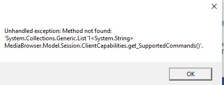

KidNamedCudi 5 Posted August 28, 2017 Posted August 28, 2017 I am receiving this error once Emby Server started back up after the most recent update (attached). Once I click ok the Emby icon disappears from the tray and I have to restart Emby to have it happen almost immediately again.
KidNamedCudi 5 Posted August 28, 2017 Posted August 28, 2017 Never mind found my answer in a different post. Need to remove the "Messaging" plugin and it works fine.
