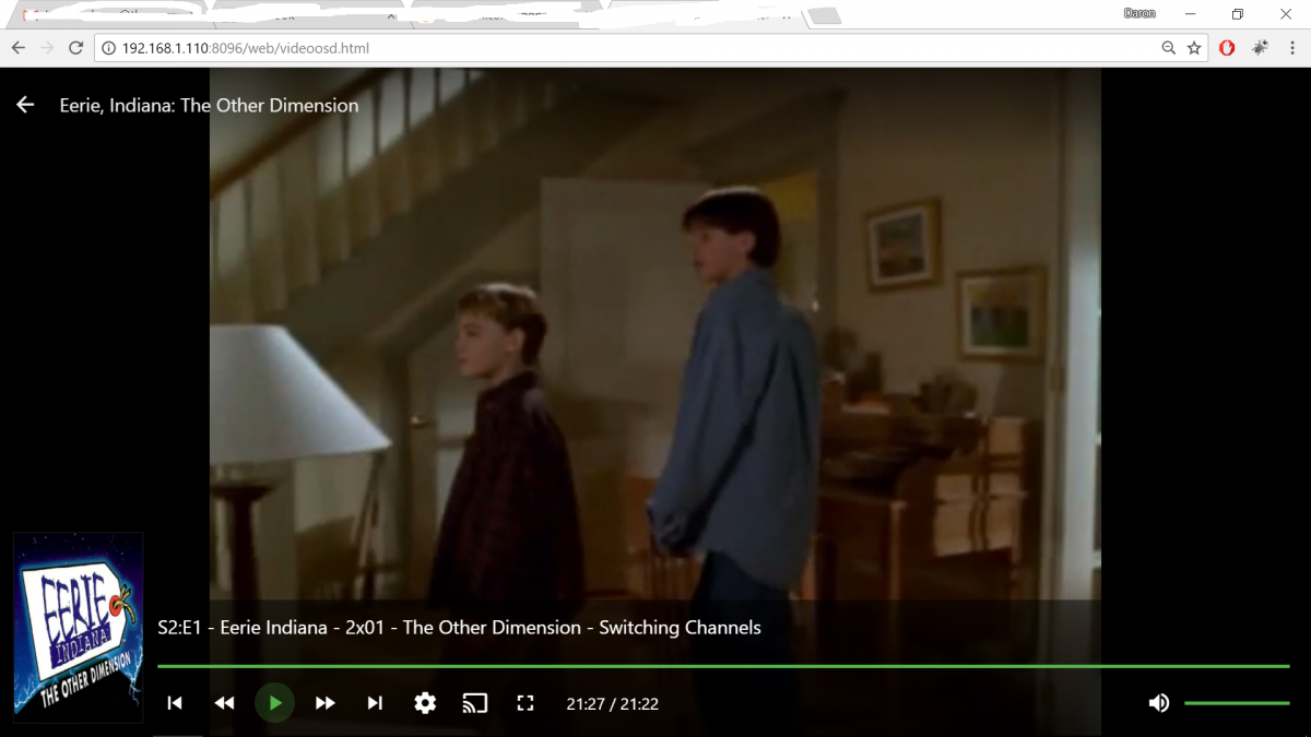

daronthomas 1 Posted August 24, 2017 Posted August 24, 2017 (edited) Having an issue where the video will not go to the next in the series but start playing the same video in the middle of the episode. So I will watch a video from my TV section and instead of playing the next episode it goes back to the middle of the episode I just watched. I also noticed that the timer keeps running even past the episode as in the image I took. Also the countdown bar at the bottom just stays at zero and doesn't disappear. This issues persists on roku @@ebr and the webapp. log.txt log2.txt Edited August 24, 2017 by Luke

Luke 42203 Posted August 24, 2017 Posted August 24, 2017 @@daronthomas, you might not like this answer but if you disable quick sync encoding then the issue will go away. We may have to do this automatically for the particular type of transcoding format that Roku and the web app are using. What's happening is the quick sync encoder is encoding with the correct timestamps and that's why you see this kind of anomaly. It's something that is likely to just resolve itself on it's own in the future, probably via an ffmpeg update once we decide to do that. Thanks.
