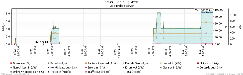

pir8radio 1313 Posted August 24, 2017 Posted August 24, 2017 I have not found a pattern yet, I have been testing FireTV and Android TV devices as a cable box replacement, and I'm noticing after watching live tv the stream stays open.... Non stop streaming over my network to the server, but it doesn't appear to be going anywhere, not writing to a drive, not being transcoded... It looks like the HDHomerun just keeps on sending. I have not tested what happens when all tuners are in use... Probably not record my shows lol... This graph shows when I was watching tv last night around 7pm and I stopped around 10pm, but the stream kept going all night, then I started watching a second show in the morning around 7am... you can see the two streams streaming 4MB each. I stopped the second stream about 20 mins later, yet it is still streaming, ffmpeg stopped running. Maybe an HDHomerun issue on the new firmware? Maybe kill signal to hdhomerun has changed? I dont know... Ill do some more testing to see what happens when all tuners are in use and I try to tune to stream...

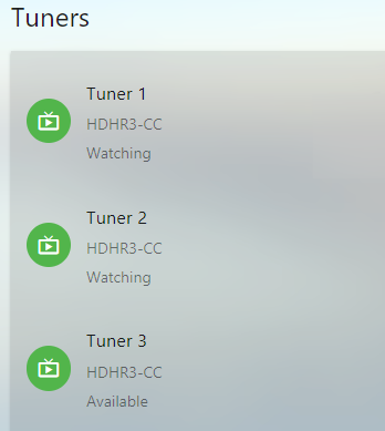

pir8radio 1313 Posted August 24, 2017 Author Posted August 24, 2017 Further testing, shows that only tuner 1 & 2 seem to be "hung up" if I tune to the channels that are in use on these hung tuners emby streams them to the client just fine, when i change channels, an inactive tuner is selected and streams the new channel, when i exit, stop or close my client the tuner frees up like normal. The issue seems to be with the first two hung tuners only... I restarted emby using the dashboard and all tuners are now freed up... So this looks to be an emby issue, not stopping those streams. FYI. Let me know if you need more info. Logs are quite huge.
