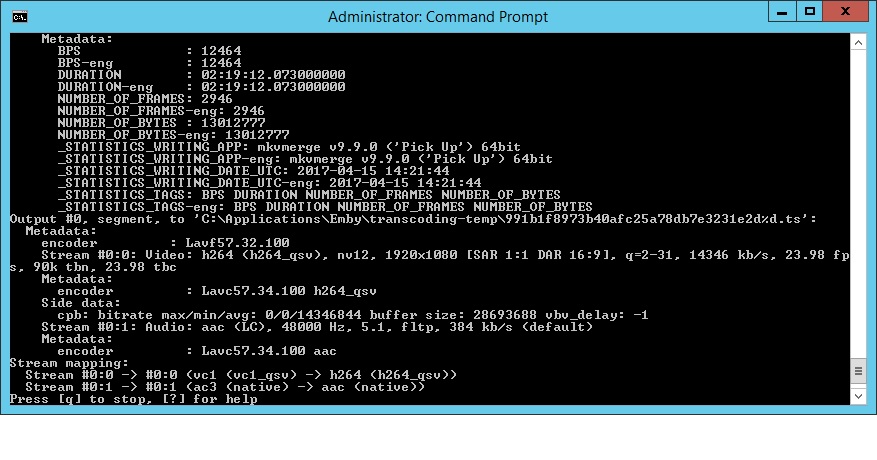

So I tried setting pointing emby back to the old ffmpeg,but unfortunately a couple of params (new?) cause the old ffmpeg to do nothing. I experiment by calling the old ffmpeg with the args from the logs and it turns out , ffmpeg 20160410 doesn't seem to like (-look_ahead 0) and (-maxrate 14346844). Once I remove those 2 params, ffmpeg 2016 works fine, but of course, emby passes those args.
Ok, so why would I want to use the old ffmpeg anyway... i would definitely prefer to use the new one, but unfortunately, ffmpeg seems to be unable to open up access to quick sync. In the old ffmpeg, with the 2 param removed, it happily starts transcoding and generating segments with no errors being reported. With the new ffmpeg, i get the following, which appears to imply it can't access qs.
