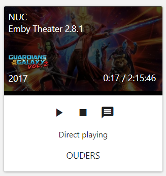

mark235 5 Posted August 22, 2017 Author Posted August 22, 2017 Apart from my previous path change being unnecessary, it also doesn't seem to help. So to start from scratch: I created a new share called "Test" with the Windows user group "Everyone" having full access, and put the testmovie in it. I created a new test library in Emby Server with the optional network share path, and played back the testmovie. Looking at the end of the log, it seems Emby's http server is still active? What Am I doing wrong? server-63639043200.txt
Luke 42243 Posted August 23, 2017 Posted August 23, 2017 In this log it's still streaming through the server. You need to make sure the machine running Emby Theater can access that network directory.

mark235 5 Posted August 23, 2017 Author Posted August 23, 2017 (edited) In this log it's still streaming through the server. You need to make sure the machine running Emby Theater can access that network directory. On my Emby Theater client pc, if I doubleclick a shortcut to the test share, I see the files, and I can read / edit / delete them. I can also browse any server UNC path from the client's Windows Explorer, since all of the server's drives are shared at the root (except for C: drive). Is there anything else I should verify or test? Access to the network shares is granted through cached credentials of the servers administrator's account. I entered those once on this client, and saved them to the credential store so they are not asked everytime I browse the shares. Is that causing the webserver to kick in? Edited August 23, 2017 by mark235
Luke 42243 Posted August 23, 2017 Posted August 23, 2017 It's really hard for me to say what's happening in your environment but I know that windows 10 updates have caused some network share related probes. The video player we use is MPV. If you would like to try downloading the standalone version you can do so here: https://mpv.io/installation/ That will give you an idea of what you should be able to expect.
