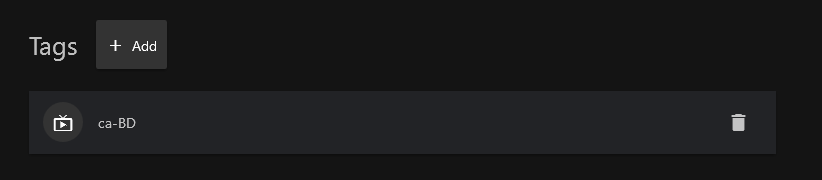

Nebular Nerd 2 Posted October 8, 2017 Posted October 8, 2017 Running Server 3.2.33.0 Cover Art 4.0.55.0 at present, having read around I used Meta Browser to bulk add 'ca-BD' to the TAG tab which then adds it to the .xml correctly (I know move to .nfo, but that's not the issue as .nfo test files do the same) Cover Art is set to interpret BD as BD, HD as HD, SD as SD. Under the old TYPE tagging all worked fine but under the new TAG based system it's very hit and miss on picking up if the Cover should be set to BD (not bothering with HD or SD just let the res determine that now) If you force a re-scan or change cover design some but not all will pick up the BD cover but checking the metadata in Emby shows the 'cd-BD' tag has been picked up on the rescan. Most odd... Can upload logs if they would help, to save ploughing through 1000's of lines anything in particular I should cut'n'paste?

Happy2Play 9802 Posted October 8, 2017 Posted October 8, 2017 Running Server 3.2.33.0 Cover Art 4.0.55.0 at present, having read around I used Meta Browser to bulk add 'ca-BD' to the TAG tab which then adds it to the .xml correctly (I know move to .nfo, but that's not the issue as .nfo test files do the same) Cover Art is set to interpret BD as BD, HD as HD, SD as SD. Under the old TYPE tagging all worked fine but under the new TAG based system it's very hit and miss on picking up if the Cover should be set to BD (not bothering with HD or SD just let the res determine that now) If you force a re-scan or change cover design some but not all will pick up the BD cover but checking the metadata in Emby shows the 'cd-BD' tag has been picked up on the rescan. Most odd... Can upload logs if they would help, to save ploughing through 1000's of lines anything in particular I should cut'n'paste? Yes this would solve the issues also, without any additional tags, changing HD/SD to BD/DVD.

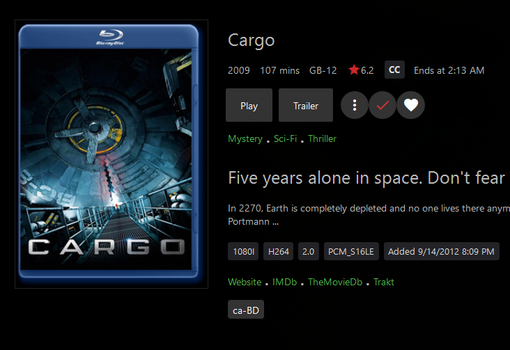

Nebular Nerd 2 Posted October 8, 2017 Posted October 8, 2017 Yes this would solve the issues also, without any additional tags, changing HD/SD to BD/DVD. I think I may of muddled the wording a bit, under the old specific TYPE tag setup I had BD,HD,SD then in Cover Art matching specifics and all was good, new setup I'm currently just aiming to get BD to behave using the new 'ca-BD' tag under the generic TAG tag. The main reason is I have a mix of HD from various sources while BD is to show it's a proper rip from a disc. For example here all is well... However here, Buried, The Car and Cargo should be showing as BD. However in the meta for Cargo we see it has picked up the tag and heading into the movie shows the BD version of the cover. Weirdness.

Nebular Nerd 2 Posted October 8, 2017 Posted October 8, 2017 So are you saying All movies presents a different cover than itemdetail cover? Nope that's the screwy thing, HD and SD are technically fine as Cover Art is just using the res and goes from there so we can ignore them, in the example shots 47 Ronin shows a correct BD cover in library and in the details screen yet Buried, The Car and Cargo only show HD on the library and BD once in the item view, all examples possess the ca-BD tag in their imported metadata. If I force a manual scan as suggested by Luke it will run through and the results will change at random, for example Ronin might break but Cargo will be fixed. Any suggestion short of locking a fixed movie then just keep running scans until they all get the idea?
Happy2Play 9802 Posted October 8, 2017 Posted October 8, 2017 Testing this I can't reproduce random changes. Only thing I needed to do after adding ca-BD is refresh the screen when I went back to all Movies from itemdetail screen. You will have to post server log to see if issue can be found.
Nebular Nerd 2 Posted October 9, 2017 Posted October 9, 2017 Testing this I can't reproduce random changes. Only thing I needed to do after adding ca-BD is refresh the screen when I went back to all Movies from itemdetail screen. You will have to post server log to see if issue can be found. How's this for weirder but almost cured it, I testing changing the TAG to ca-SD and that worked straight away, then tried ca-HD and that still left the SD in place, tried ca-BD and still the SD, but the detail view reflected the changes. so for giggles I added HDDVD=BD to specifics and went back to the library to play around and suddenly everything works, looks like CoverArt was not reading the specifics quite right for some reason until I changed them, maybe whatever stores the specifics had gone wonky as it forced a big refresh when I went back to the library view. Tried deleting all the specifics and it would not let me delete them, so completely uninstalled the plugin and manually deleted the config file. Reinstalled and fixed. Short version, CoverArt's config .xml had borked itself at some point and only showed up when major changes to the database in regards .xml and tag handling caused it to appear. Thanks for suggestions and advice it certainly helped try and pin down the culprit.
