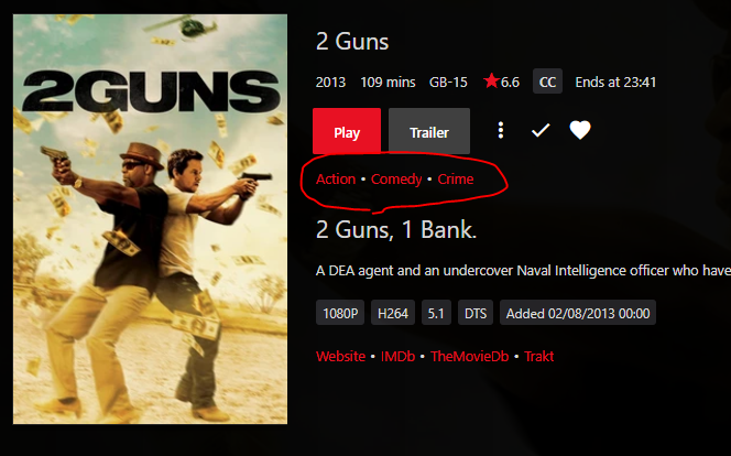

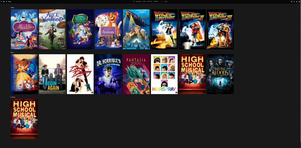

QDivision 42 Posted August 20, 2017 Posted August 20, 2017 Hi, When viewing genres through the web interface only a select few are showing. This is on a fairly recent clean build of windows 10 and Emby. When viewing the synced data through Kodi all the genres are there. When you look at a individual title you can see that genres are listed but when you click on one it shows a blank page. I have never installed Genre Cleaner so the issue isn't with that.

QDivision 42 Posted August 21, 2017 Author Posted August 21, 2017 I've also added 2 more movies and the same thing happens. It's downloads the metadata successfully. But the genres assigned to them don't show in the genre page. I don't think it's an issue with the nfo files being in use.
QDivision 42 Posted August 21, 2017 Author Posted August 21, 2017 I've removed my movie library and deleted the emby library database (kept all the nfo files and photos) then re-added the movie library and scanned. The genres are now all appearing.
