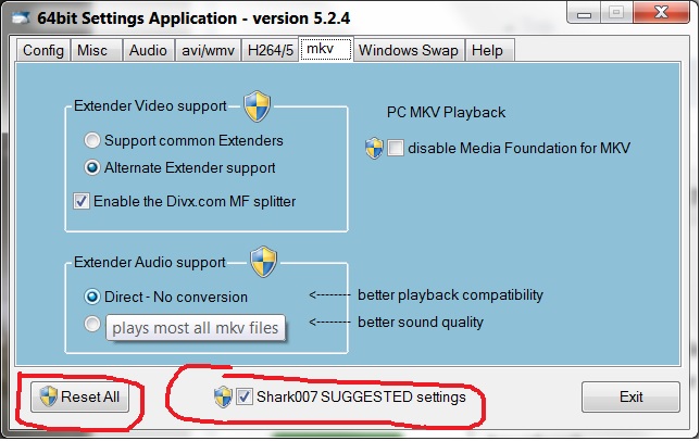

d00zah 152 Posted August 14, 2017 Posted August 14, 2017 (edited) Morning, I can't seem to get flv files to play through Emby for WMC, I have installed shark codec and I can get it to play in Windows Media Player and if I right click on the .flv file (Movie/Series) and open with WMC it plays but just not inside Emby. Any ideas? Are you running a 64-bit version of Windows? If so, Shark007 codec packages have both an x86 & x64 component. Windows media player is, by default, a 32-bit app while WMC is 64-bit. Based on your description, it sounds like you've got things set up correctly for 32-bit, but not 64-bit. Open BOTH Shark007 32-bit / 64-bit Settings Application GUIs. On EACH, 1st select the 'Reset All' radio button in the lower left-hand corner, followed by rechecking 'Shark007 SUGGESTED settings'. This usually clears up most playback issues. Edited August 14, 2017 by d00zah

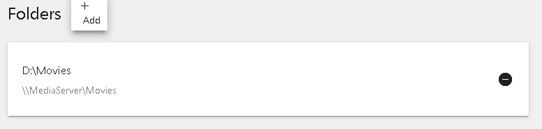

Adriaan 2 Posted August 16, 2017 Author Posted August 16, 2017 See attached, this is how I have my folders setup at the moment.
Luke 42237 Posted August 16, 2017 Posted August 16, 2017 If the media is on the same machine at the server then try using the direct folder path rather than they network path
