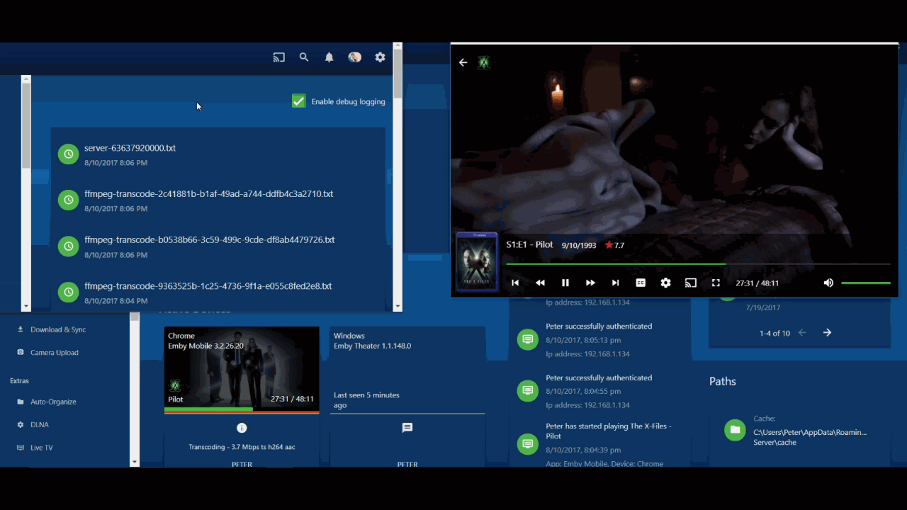

Guest asrequested Posted August 11, 2017 Posted August 11, 2017 (edited) So I was playing around with this. Using chrome to watch an HEVC video, so it would transcode it. The dashboard doesn't seem to show that it's transcoding again, but multiple ffmpeg logs are made. Is that supposed to happen? And sometimes playback freezes for bit. Though, that may be unrelated. I made a big GIF of this happening, 28MB. If you want to see it? And I tried it with and without QuickSync enabled. Same result. Edited August 11, 2017 by Doofus
Guest asrequested Posted August 11, 2017 Posted August 11, 2017 Please see post #6, thanks ! Right! Here is the GIF and the logs generated during the test. As mentioned, played an HEVC encoded show in the chrome. As you will see, the red line is complete, indicating fully transcoded. I then skipped around, backward and forward over 6 minutes. The GIF is approximately the last minute and a half (I know it's a bit long). The red line remains full, but you will see that I had a window open with the logs in it. I would refresh that window and new transcode logs of the show I was watching would be generated. The question is, is that expected behavior? If not, why is this happening? The server log is big, the time frame, as you can see in the GIF, is around 8:06pm.

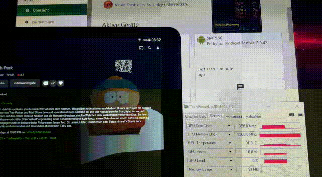

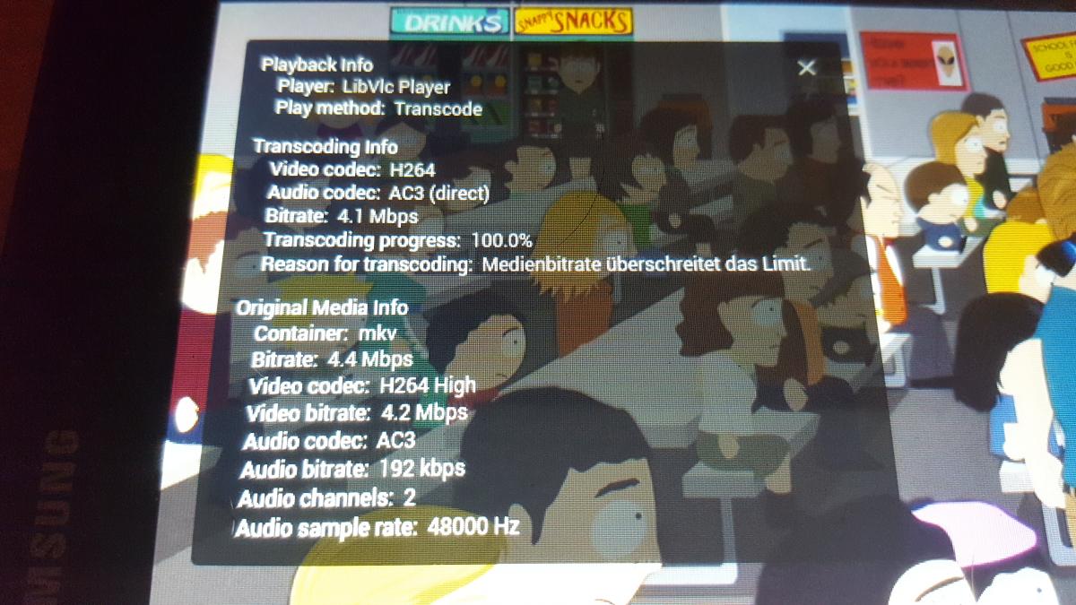

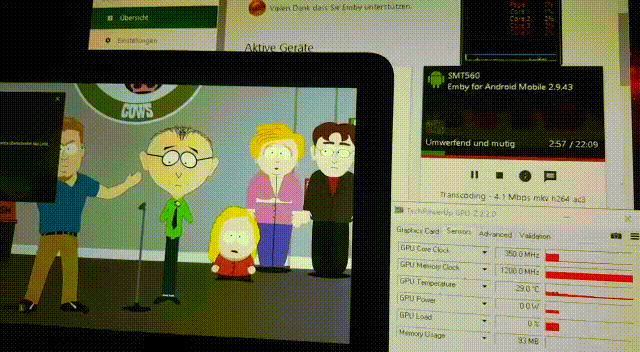

atropa 10 Posted August 11, 2017 Author Posted August 11, 2017 (edited) Hey. Yes i am on the stable release. 1.Transcoding starts 2. Transcoding ended and cpu gpu go idle 3. On the tab it is 100 percent transcoded 4. Seeking starts a new transcoding session Doesnt matter which file format it is. Hevc or x264. If it has to be transcoded, it happens. Edited August 11, 2017 by atropa
Guest asrequested Posted August 11, 2017 Posted August 11, 2017 Yup! Watching the stats while seeking, you can see transcoding change from 100% to a lower percentage.

atropa 10 Posted August 11, 2017 Author Posted August 11, 2017 But it is not only the red progress bar. The transcode has completely ended. It doesnt matter how long i wait. Even if i wait almost until the end of the movie ,if i seek the transcode starts. Android app shows 100 percent and after seeking it goes to 40 or 60 or wherever i seek to. Strange.....
