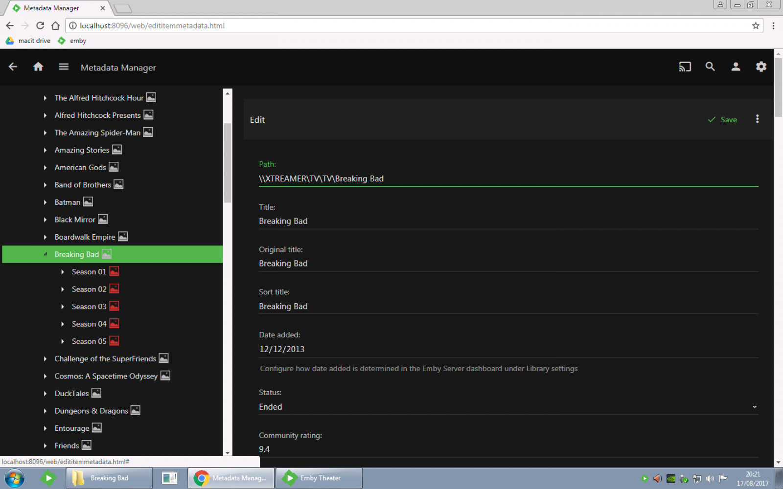

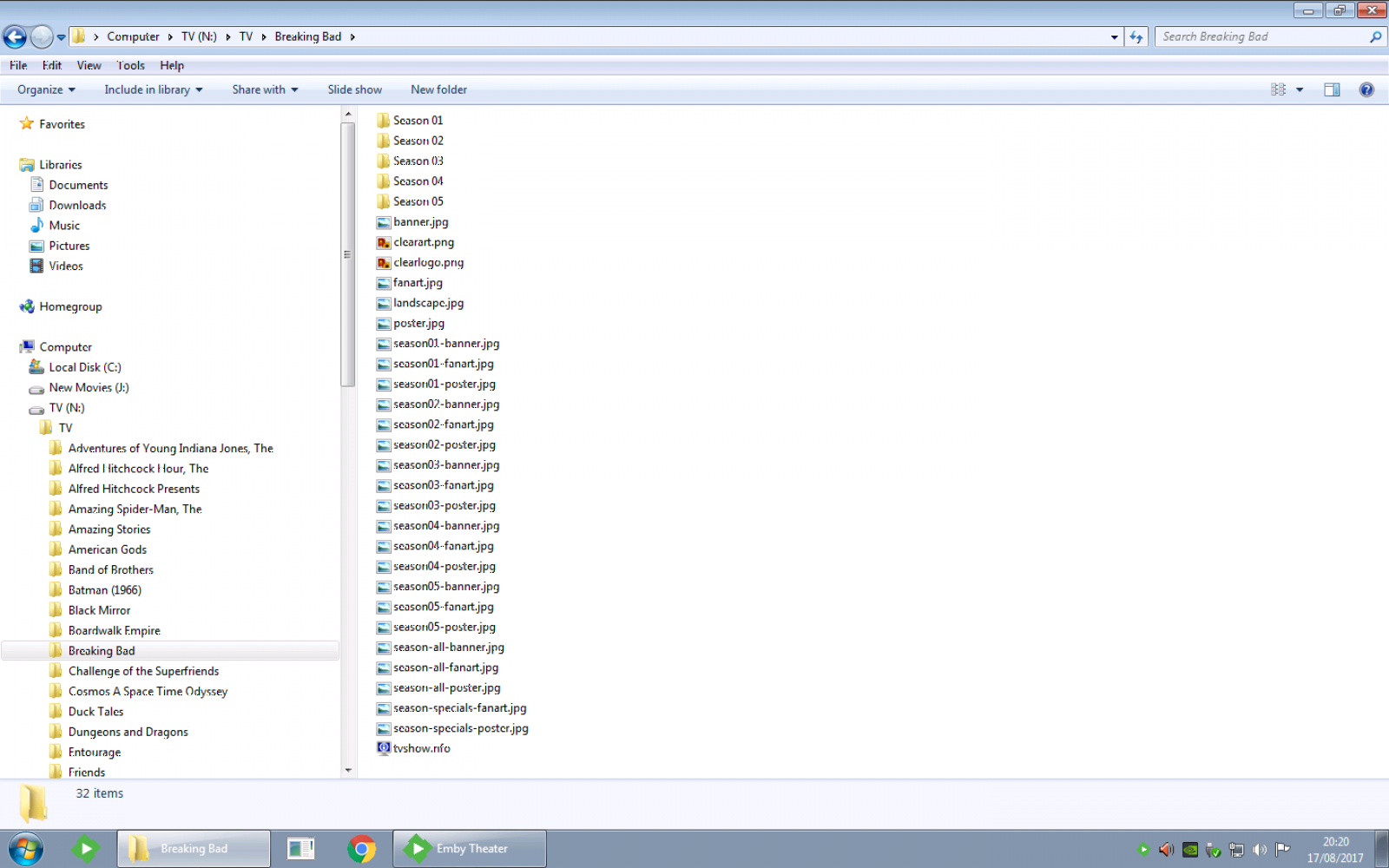

amaga 4 Posted August 17, 2017 Author Posted August 17, 2017 Hi Luke Thanks for the help. I'm attaching two images - one of the folder structure for Breaking Bad and another showing that in metadata manager it says there is no season posters. Is there any log file I can view? This only happens in some shows, not all.
Luke 42203 Posted August 18, 2017 Posted August 18, 2017 If you click on each season in the metadata manager, do they have a season number filled in?
amaga 4 Posted August 19, 2017 Author Posted August 19, 2017 That solved it Luke. Thanks! A suggestion for a feature is, when a tv show library is re-scanned, Emby could check the folder name to try to figure out the season number, if it is missing. That would prevent this from happening. Once again, thanks for the help.
