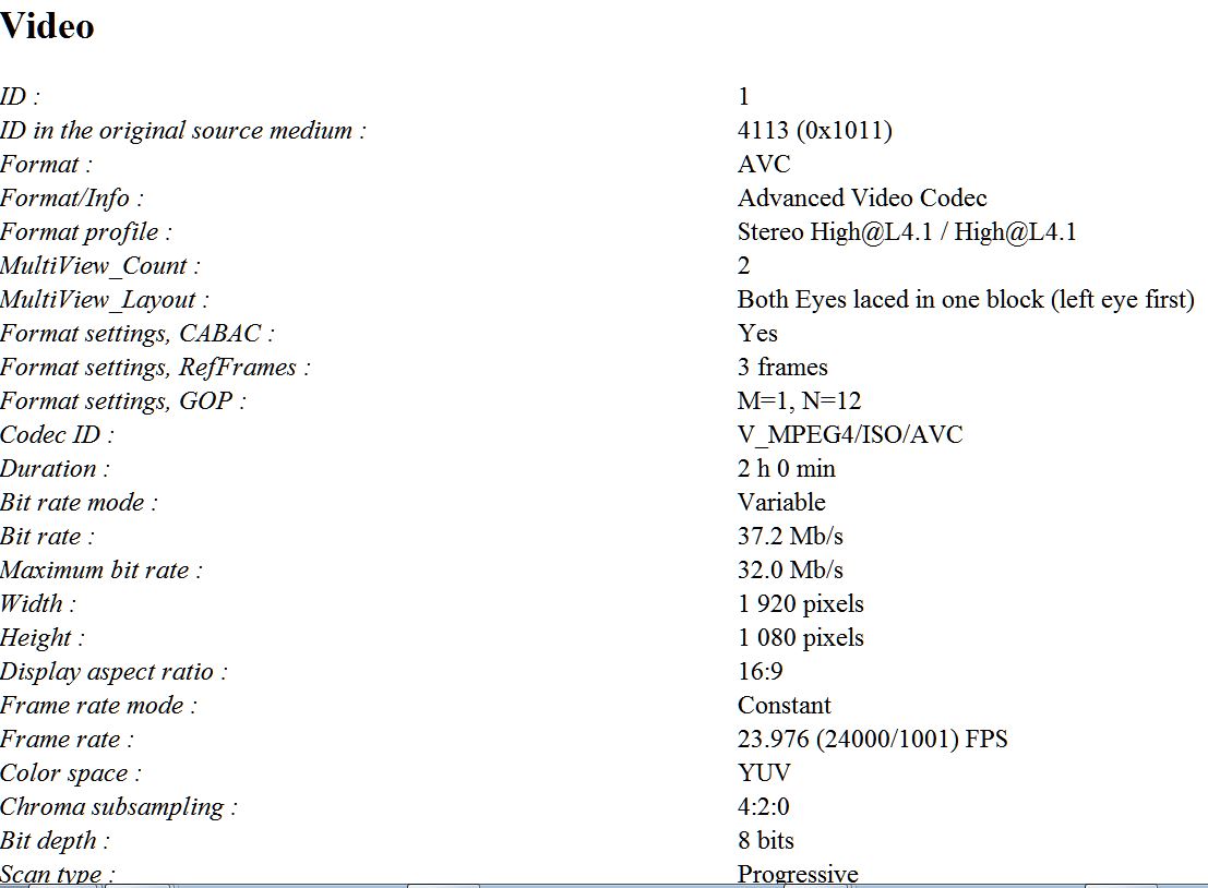

Sammy 791 Posted August 7, 2017 Posted August 7, 2017 (edited) Will an mkv encoded as in the screen grab below playback in ET using madVR on Win7x64 or do I need to re-encode it to Half SBS or something else? If I have to re-encode, how? Edited August 7, 2017 by Sammy

Sammy 791 Posted August 8, 2017 Author Posted August 8, 2017 Tried it. No worky. Going to try mounting the iso then playback with ArchSoft TMT5. Can that player or the WMC Plugin thereof be loaded in ET for iso? Otherwise, I am also looking into converting the MVC 3D to a SBS 3D mkv. Slight loss in video quality but not really noticeable. What program does this? TIA Sent from my SM-G930P using Tapatalk

Sammy 791 Posted August 8, 2017 Author Posted August 8, 2017 With an external player in Emby Theater you can use any player that supports command line control. I do not know if ArchSoft or WMC supports this so you will need to research that. Thanks. Thanks, Luke. I'll do a little bit of searching. TMT 5 is old and out of print so to speak but it does bypass Cinavia Audio Watermarking or it just doesn't use it at all actually. Looking for the least path of resistance. For a one-off, loading the iso in TMT 5 is probably easiest. For long term playback from the Emby library, re-encoding to SBS is probably best.. That said, how to force Emby to recognize a 3D as 3D? I have a few movies where I have both in the library and they both show the 2D Cover Art with no distinction anywhere in ET. Thanks.
