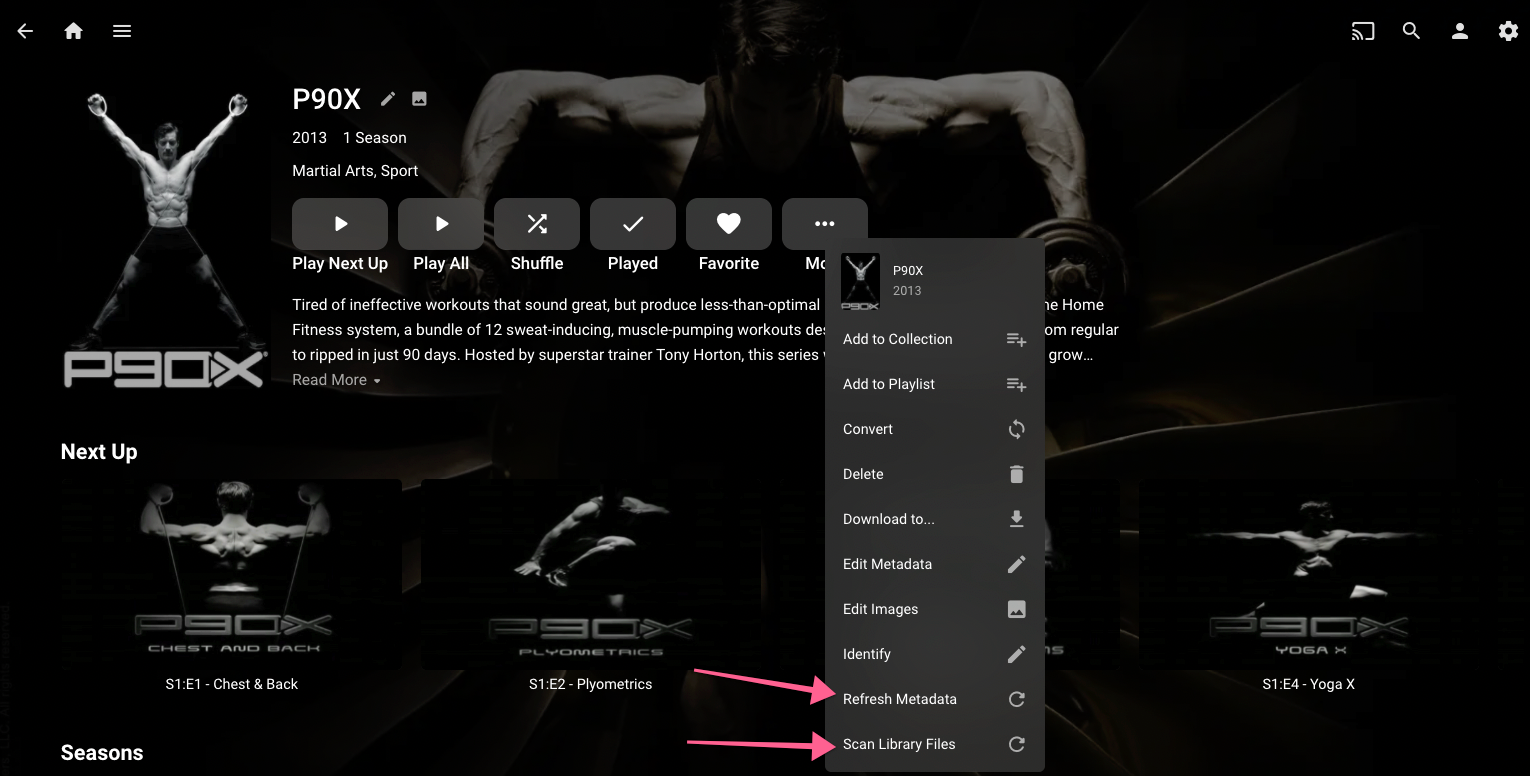

vdrover 62 Posted January 4, 2022 Posted January 4, 2022 I see. Adding `.ignore` marks it as hidden. I have a TV library on a linux box. For a show, I have the episodes in the parent folder and I have some PDFs in a subfolder. Currently, it thinks the subfolder is an extra season. I added '.ignore' to the subfolder, rescanned the library, and updated the meta data. But still the subfolder is showing up as an extra season. Any tips?

vdrover 62 Posted January 4, 2022 Posted January 4, 2022 I had paid close attention to the permissions, but that didn't help. I solved it my scanning the library and refreshing the meta data from the scheduled tasks area vs the links in the main app.

vdrover 62 Posted January 5, 2022 Posted January 5, 2022 I was expecting the .ignore files to be respected and the extra "seasons" to disappear. When I used the scan/refresh feature from the scheduled tasks area, it worked as expected.
vdrover 62 Posted January 6, 2022 Posted January 6, 2022 So the links in the library area don't work? Is there a bug report to file?
Happy2Play 9802 Posted January 18, 2022 Posted January 18, 2022 7 minutes ago, Luke said: @Happy2Play are you able to reproduce? Not sure what to reproduce. On 1/5/2022 at 4:43 AM, vdrover said: I was expecting the .ignore files to be respected and the extra "seasons" to disappear. When I used the scan/refresh feature from the scheduled tasks area, it worked as expected. On 1/6/2022 at 9:34 AM, vdrover said: So the links in the library area don't work? Is there a bug report to file? If I understand this correctly this is a page refresh issue, correct? As adding a .ignore file removes any folder I add it to, but obviously from Item Deatails you have to manually refresh the page.
vdrover 62 Posted January 19, 2022 Posted January 19, 2022 @Happy2Play I don't think it's a page refresh issue. For me, if I add the .ignore file to a folder and click `scan library files` from the Series menu, the ignored files remain. I have to use `scan library files` in the scheduled tasks area.
Happy2Play 9802 Posted January 19, 2022 Posted January 19, 2022 5 hours ago, vdrover said: @Happy2Play I don't think it's a page refresh issue. For me, if I add the .ignore file to a folder and click `scan library files` from the Series menu, the ignored files remain. I have to use `scan library files` in the scheduled tasks area. What are you calling the Series menu? Can you go over a specific example with exact steps as any method I have tried removes folder items that contain a .ignore.
