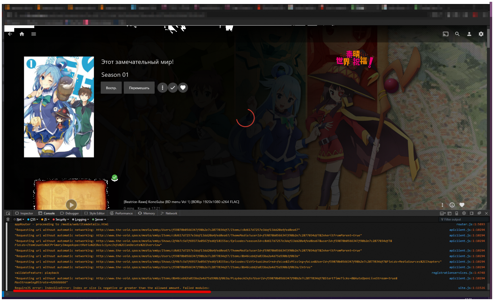

Ryogo 0 Posted July 28, 2017 Posted July 28, 2017 Playback is not working in FF/Chrome. The issue persists from 22 version (first version I installed) through 26 version (latest). Note: playback works in incognito mode both in FF and Chrome.

Luke 43458 Posted August 4, 2017 Posted August 4, 2017 Was there anything more in the browser debugger?
Ryogo 0 Posted August 4, 2017 Author Posted August 4, 2017 @@Luke no, nothing at all. You could check it yourself if you have time. log with error: https://pastebin.com/AVVR0NKd log without error: https://pastebin.com/J2AxW035

Ryogo 0 Posted September 21, 2017 Author Posted September 21, 2017 @Luke Updating to 31 version does not helped, but anyway - I've tracked down the issue. It is in htmlvideoplayer/plugin.js in createMediaElement method. videoElement.volume = htmlMediaHelper.getSavedVolume() this is the line that causing a problem. videoElement.volume expects value from 0 to 1, but htmlMediaHelper.getSavedVolume() returns 50 and setting 50 to videoElement.volume is causing exception to be thrown.
Solution Luke 43458 Posted September 21, 2017 Solution Posted September 21, 2017 Thanks for the info. Try clearing browsing data. I think what is probably happening is you have an old value saved in your browsing data on a 0-100 scale. The newer code saves it as 0-1. Thanks. 1
