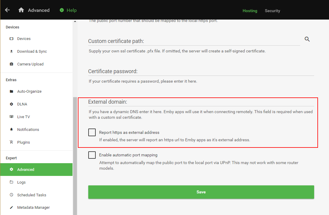

darkassassin07 672 Posted July 28, 2017 Author Posted July 28, 2017 (edited) alright, I have finally managed to get an ssl cert via letsencript and point emby at it. (with the correct pass and domain name) After a clean restart I still can't connect on port 8920 through any means. However if I ping port 8920 via http://canyouseeme.org/ I do get a response now where I didn't with the self-signed cert. I'm also getting this log with a few errors: edit: in the first few lines of the log: "EnableHttps":false ?? server-63636798768.txt Edited July 28, 2017 by darkassassin07

ebr 16309 Posted July 28, 2017 Posted July 28, 2017 edit: in the first few lines of the log: "EnableHttps":false ?? Did you enable this?
darkassassin07 672 Posted July 28, 2017 Author Posted July 28, 2017 the external domain I do have set, I just tried enabling "report https as external address" to no avail. :/ here's another log: server-63636823433.txt
