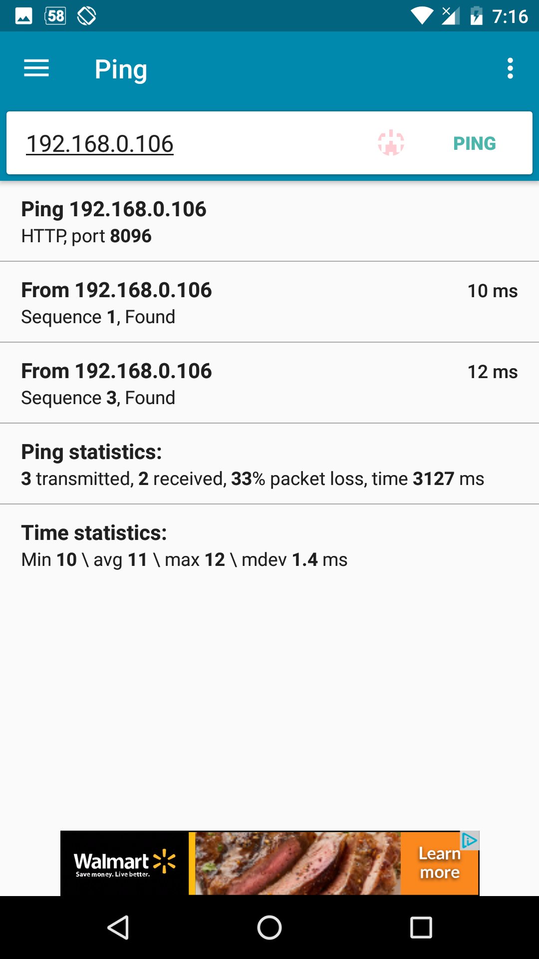

darkassassin07 672 Posted July 26, 2017 Author Posted July 26, 2017 Using "ping tools network utilities" from google play android if I probe port 8096 I get a response, however probing port 8920 yields no response
