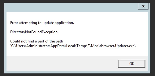

Hi @@Luke,
Just an FYI, i let emby do the update through the dashboard and when i click restart, here is the error that is displayed on the server machine. Tried a couple times.
clicking OK aborts the update and starts up the previously installed (.24) version.
Downloading the server installer and re-installing ontop of current version updated ok however.

Thanks, installing the latest from the website should do it.

I still get this error if I install directly from the server. This is for 3.2.26.0 or even 3.2.26.3 in the beta channel.
The issue is that the server detects 3.2.24 as being outdated, and when it tries to install the latest version, it fails, and then the server never gets restarted.
