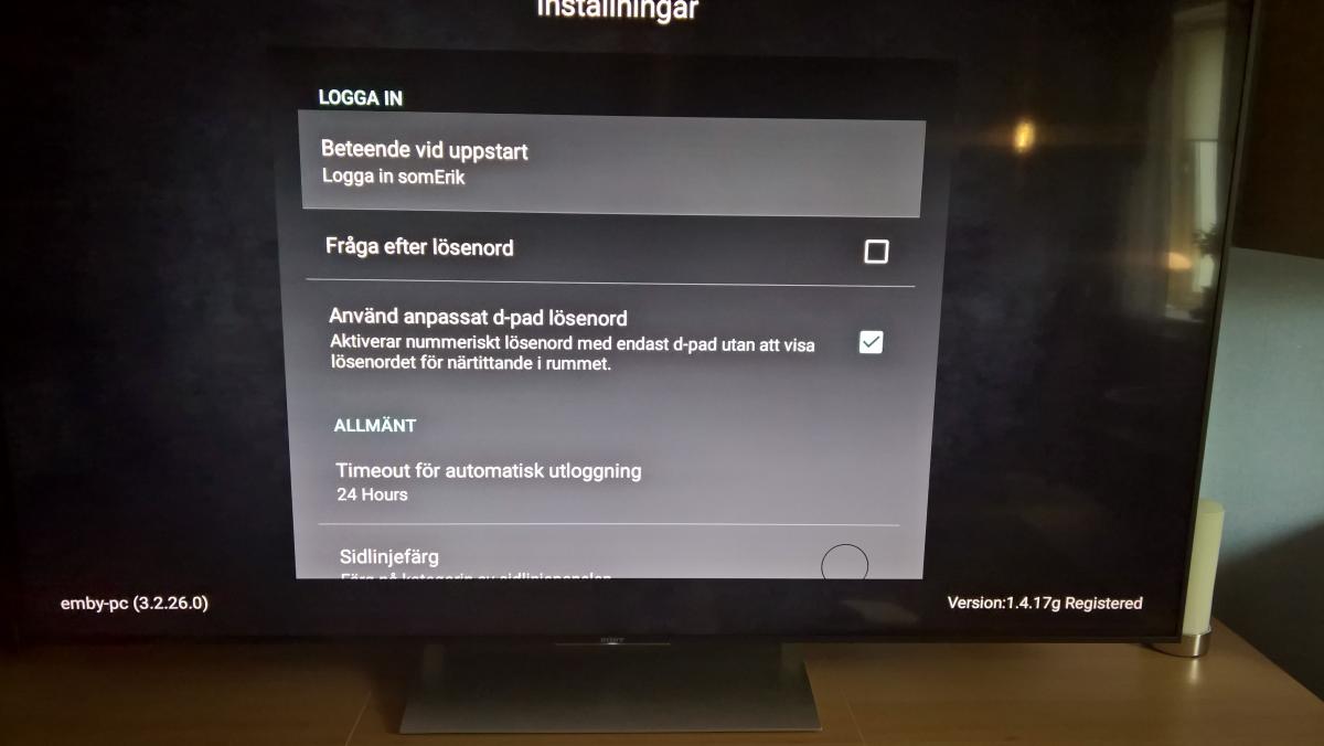

ebr 16337 Posted July 24, 2017 Posted July 24, 2017 Can you show me the settings page for the app? (take a picture of it)
redaktorn 24 Posted July 24, 2017 Author Posted July 24, 2017 Hi, Thanks again for reply. While I remember I should also mention that in Emby Server it says "if pin code is left blank" I should be able to log in without password. Also that is not true. Attached pictures of my settings. With this setting I cannot log in with pincode. (Not with a 4 digit and not leaving it blank)If I remove the D-pad setting I can log in with my long secure password. But I will be logged out after 24 hours. Maybe you can add a setting for never under the timeout you can chose? (24 hours is maximum as it is now) P.S: If you look the picture of D-pad you see what I mean with double clicks that are not working. Trying to make example 7 gives you 2+2 and not 7. (You will get 2 circular dots indicating 2+2 no matter how quick you double click) All the Best
ebr 16337 Posted July 24, 2017 Posted July 24, 2017 Yes, I can add never to the options for auto logout. That's a good idea. But, I'm not sure why the Easy PIN isn't working properly but I think that is the root of the issue. As a test, can you try setting up a user with a simple normal password and then set the app to automatically log in that user and see if it works as expected (bypassing the password challenge)?
