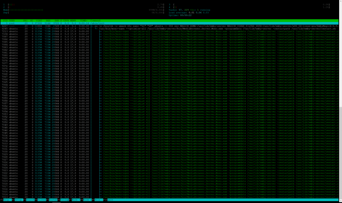

angusleung 6 Posted July 17, 2017 Posted July 17, 2017 I have been using emby with Cloudflare more than a year and everything running good until few weeks ago the server start running slow. It happen when I reload the webpage few time. The time took to reload the page is about 1 min to 2 min I noticed that there are about hundred threads were created when I reload the page when I access it with my domain name. And emby will start running slow when threads more than 200-300. It won't happen when I access locally and the number of threads are around 30 to 40. I have tried to disable all caching related features on Cloudflare (Paging rule, rocket loader, Auto Minify, etc.) to see if its help , but no luck. I tried everything I could do this few weeks and finally I think I could look for help on the forum. Does anyone faced similar situation and would give me some advice? I have attached the server log and some screenshot. I am running Version 3.2.25.0 on ubuntu 16.04 server.txt

mastrmind11 722 Posted July 17, 2017 Posted July 17, 2017 I have a similar htop. When you search for a process it doesn't filter other threads. My guess is that you have less than 100 threads for Emby.... you have to count them. eg, my htop w/ emby filtered shows 1176 threads, 84 of which are Emby. In other words, get better hardware and/or Emby is not the problem.

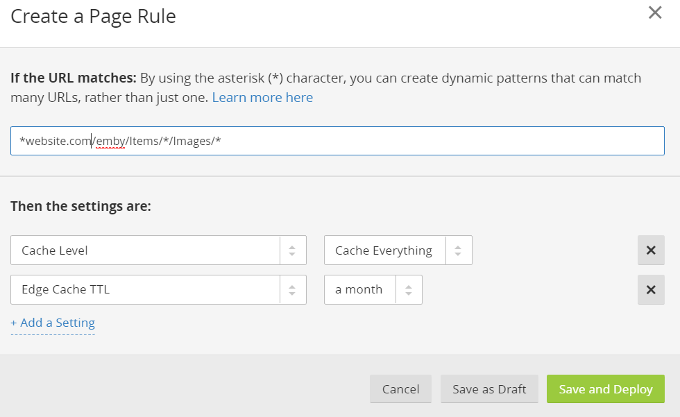

Solution pir8radio 1313 Posted July 20, 2017 Solution Posted July 20, 2017 Ok, turns out the speed issue is about the setting of Cloudflare. I try to access my server via external IP and domain name, the speed is significantly difference. I tried several difference setting, turn on minifiy and rocket. The speed seems slightly improved. Once again, thanks for the support. You will find some of cloudflares speed settings should not be enabled. Rocketloader causes some issues, so does minifiing. Make sure your cache level is set to STANDARD (important), and create this rule: without this rule emby images don't get cached because they are .webp images with no extension. Use chrome, right click the page go to inspect, select "NETWORK" tab, check the disable cache box. Add a column/header "cf-cache-status" this will show you what was actually cached on cloudflare.. see below image, the majority of your content should say "HIT" after you reload the page a few times... There on out HIT should be listed for most everything. 2
