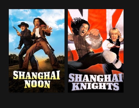

BigGoose62 72 Posted July 3, 2017 Posted July 3, 2017 When viewing movies, the sort title is not being recognized when attempting to sort alphabetically. For example, the movies Shanghai Noon and Shanghai Knights have sort titles of "Shanghai Noon 01" and "Shanghai Noon 02" respectively. But they appear in the order of Shanghai Knights then Shanghai Noon. So the actual title is being used over the sort title. This is happening for all my movies, but not in my documentaries folder. Also, when using the Sort feature of the Web App, roughly half of the options do not work. I used to be able to set it to sort by Date Added Descending and I could see all my movies starting with the most recently added. But now that doesn't work. It just puts them in alphabetical order. Any help would be greatly appreciated.

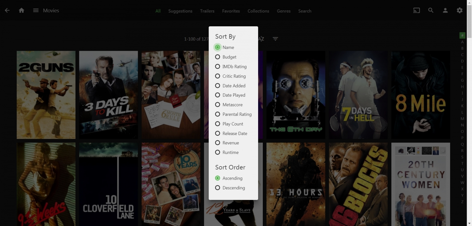

BigGoose62 72 Posted July 5, 2017 Author Posted July 5, 2017 Are you positive the view in question is set to sort by name? Yes, when viewing the "All" tab for my movie library, I have the sorting set to Name-Ascending. This displays by the "Title" and ignores the "Sort Title." Is there anywhere else to change the sort settings that I can check? And as I posted originally, several of the other sorting options are not working correctly. The Date Added-Descending was something I used frequently, so I know this is a recent issue. Thanks for your help!

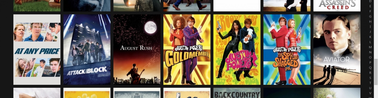

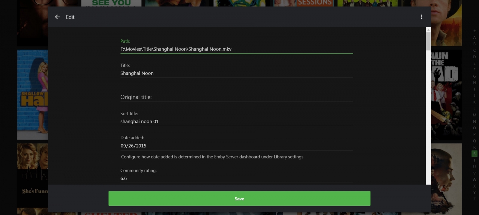

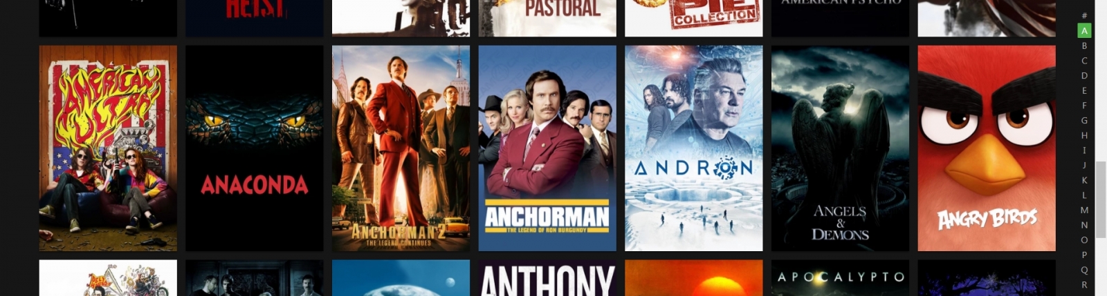

BigGoose62 72 Posted July 6, 2017 Author Posted July 6, 2017 Can you show a screenshot? thanks. Here are some screenshots. Thanks for helping. 1) Shows the incorrect order of Shanghai Noon & Shanghai Knights 2) Shows Shanghai Knights with a Sort Title of Shanghai Noon 02 3) Shows Shanghai Noon with a Sort Title of Shanghai Noon 01 4) Shows Anchorman 1 & 2 doing the same thing, as well as Angels & Demons not following its Sort Title of "Da Vinci Code 02" 5) Shows Austin Powers 1-3 doing the same thing 6) Shows the start of my movie library with sorting set to Name-Ascending 7) Shows the start of my movie library with sorting set to Date Added-Ascending. Notice it still sorts alphabetically. Changing it to Date Added-Descending starts with my collections and then Z-A. 8) Shows that sorting by Runtime-Descending still works
